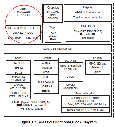

The BBB's AM3359 silicon has a number on on-chip devices, including a 3D graphics engine. It's not something I'm knowledgeable in, but I was curious in simpler 2D effects and sound and video. The ARM processor within the AM3359 actually contains NEON capability which according to the documentation is a way of executing special instructions on multiple pieces of data at the same time, while normal instructions continue to run.

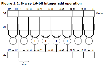

NEON is built on something known as SIMD (Single Instruction Multiple Data) which takes advantage of the fact that although processors may have (say) 32-bit wide registers, some real world algorithms or media applications may only require 8-bit or 16-bit data. The larger register can be populated with more than one item of data, and then the processor hardware can execute the particular instruction (such as add or multiply) in parallel. They are known as vector operations.
(Note: Prior to NEON, there was a technology known as VFP (Vector Floating Point) that also had vector operations, but were not executed in parallel. According to this URL it appears that we can identify NEON instructions as beginning with 'v' and VFP instructions begin with 'f'.)
NEON takes SIMD beyond 32-bit and amongst other features, offers 128-bit registers, which can handle (as an example) eight items of data, each 16-bits wide (16x8=128) simultaneously.

The diagram was translated into this code, and  Q1 and Q2 were populated with some data from RAM:
vld1.16     {q1}, [r0:128]
vld1.16     {q2}, [r1:128]
vadd.i16    q0, q1, q2
vst1.32     {q0}, [r2:128]
Load instructions (such as vld) take their operands in this direction:
vld dest<--src
Store instructions (such as vst) work in the opposite direction:
vst src-->dst
Using this information, it can be seen that the first instruction takes 128 bits of data starting at the address in register r0, and dumps it into the NEON Q-register called q1.
The next line takes 128 bits of data starting at the address in r1, and stores in q2.
The NEON instruction vadd is responsible for performing a parallel addition, storing the result in q0.
Finally, the vst operation places the contents of q0 (128 bits as mentioned) into the address space beginning at the address stored in register r2.

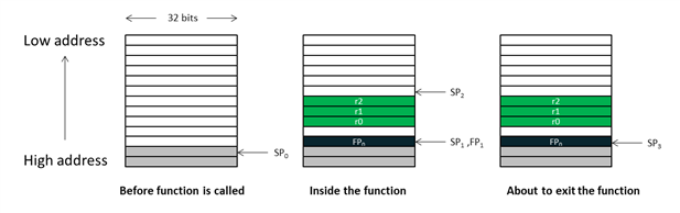

The stack grows downward in address space. At this point it's easier to look at a diagram. The diagram is inverted, so that a rising (i.e. growing) stack is actually decreasing in address. Each block in the diagram represents 32 bits, i.e. the stack address reduces in steps of 4 bytes as the stack grows.
Before neontest was called, the stack pointer was at a certain location shown on the first diagram (marked as SP0).
Upon entry to the neontest function, the assembler code shown above was executed. The first line stores the frame pointer (fp) register (it is r11) at the address of SP-4, i.e. in the block above. It is shown in black in the middle diagram.That same line also then decreases the value of SP by 4 (the exclamation mark on that line causes that). So, SP now points to the location marked as SP1 in that middle diagram.
The second assembler line sets fp to equal sp. It is marked as FP1.
The third assembler line decreases SP by 20 bytes, i.e. 20/4 or 5 blocks in the diagram. So, SP is now pointing to the location marked SP2 in the middle diagram.
The fourth assembler line stores r0 (which contained the address of data1) in location fp-8, or in other words two blocks (8 divided by 4) up from the address in fp (which happens to be the location FP1).
The remainder two lines do a similar type of thing to r1 and r2.
The skipped 4 bytes (the white space between FP0 and r0 in the middle diagram) are used to store the link register if required, according to this diagram (which is upside down compared to the diagram above).
After the neontest function is close to completion, the following assembler code is executed before control returns back to the main() function:
add    sp, fp, #0
ldmfd    sp!, {fp}
bx    lr
The first line sets SP to equal FP+0, i.e. it quickly moves the stack pointer to the location FP1. So, on the last diagram, it can be seen that the stack pointer is now at the location indicated as SP3. That location happens to contain the earlier contents of fp.
So, we now need to populate fp with that older value, set the SP back to the old SP0 value (shown on the first diagram) and set the program counter to the link register value.
The second assembler line above is responsible for popping off the value FP0 and auto-updating the SP value, so that it moves from the location SP3 back down to the old SP0 value.
Finally, the last assembler line is responsible for jumping to the address in the link register (lr).
