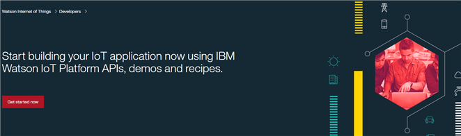

In a few easy steps you can sign up for then IBM Bluemix account before we look at the hardware you'll need to get started with IBM - Explore IoT
{gallery} Joining IBM Watson
Step One: Visit the IBM Explore IoT site and click Sign Up
Step Two: Fill out your details on IBM Bluemix
Step Three: Confirm Sign Up with your E-Mail
Step Four: You'll be put onto a premium trial first, but this falls back to a free account.
Step Five: At the login prompt, your IBM ID is your e-mail
In case you missed it in the image gallery overlay, your IBM ID is your e-mail address.
