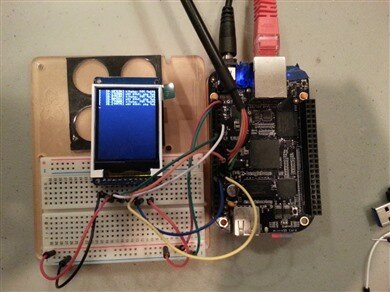

Use fbtft_device kernel module to load the fb_st7735r driver for Adafruit 1.8" TFT LCD display connected to SPI1:
$ sudo modprobe fbtft_device busnum=1 name=adafruit18 debug=7 verbose=3 gpios=dc:48,reset:60
OR
Use fbtft_device kernel module to load the fb_ili9340 driver for Adafruit 2.2" TFT LCD display connected to SPI1:
$ sudo modprobe fbtft_device busnum=1 name=adafruit22a debug=7 verbose=3 gpios=dc:48,reset:60
NOTE: a suffix is important in adafruit22a
/dev/fb0 device should now exist:
$ ls -lsda /dev/fb*
0 crw-rw---T 1 root video 29, 0 Oct 30 06:27 /dev/fb0
The system console should now be displayed on the LCD:
More photos of fbtft working for 1.8" & 2.2" TFT LCDs

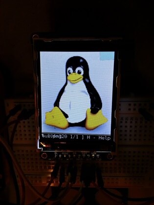

Install fbi utility to display image files on the framebuffer device:
$ sudo apt-get install fbi
$ wget https://kernel.org/theme/images/logos/tux.png
$ sudo fbi -d /dev/fb0 -T 1 -a tux.png
using "DejaVu Sans Mono-16", pixelsize=16.67 file=/usr/share/fonts/truetype/ttf-dejavu/DejaVuSansMono.ttf
Tux the Linux mascot should now be displayed on the LCD:

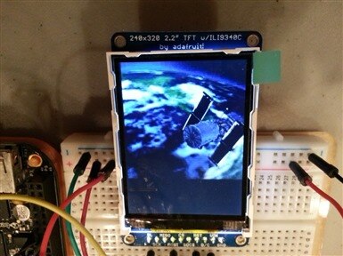

Next, install mplayer to play a MPEG-2 video clip:
$ sudo apt-get install mplayer
$ wget http://hubblesource.stsci.edu/sources/video/clips/details/images/hst_1.mpg
$ sudo mplayer -nolirc -vo fbdev:/dev/fb0 scale=WIDTH:128 hst_1.mpg
MPlayer svn r34540 (Debian), built with gcc-4.6 (C) 2000-2012 MPlayer Team
Playing scale=WIDTH:128.
File not found: 'scale=WIDTH:128'
Failed to open scale=WIDTH:128.
Playing hst_1.mpg.
libavformat version 53.21.1 (external)
Mismatching header version 53.19.0
MPEG-ES file format detected.
VIDEO: MPEG1 320x240 (aspect 1) 29.970 fps 320.0 kbps (40.0 kbyte/s)
Load subtitles in ./
Opening video decoder: [ffmpeg] FFmpeg's libavcodec codec family
libavcodec version 53.35.0 (external)
Mismatching header version 53.32.2
Selected video codec: [ffmpeg1] vfm: ffmpeg (FFmpeg MPEG-1)
Audio: no sound
Starting playback...
Unsupported PixelFormat 61
Unsupported PixelFormat 53
Unsupported PixelFormat 81
Could not find matching colorspace - retrying with -vf scale...
Opening video filter: [scale]
Movie-Aspect is 1.33:1 - prescaling to correct movie aspect.
[swscaler @ 0xb670f978]No accelerated colorspace conversion found from yuv420p to rgb565le.
[swscaler @ 0xb670f978]using unscaled yuv420p -> rgb565le special converter
VO: [fbdev] 320x240 => 320x240 BGR 16-bit
framebuffer too small for double-buffering, disabling
V: 19.0 570/570 20% 65% 0.0% 0 0
Exiting... (End of file)
You should now see the video clip playing on the display:
