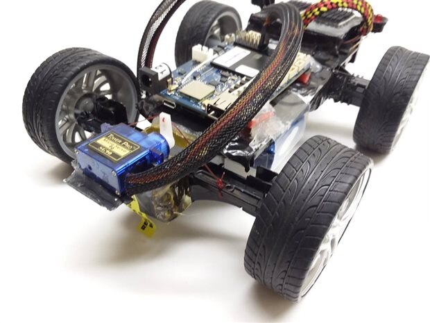

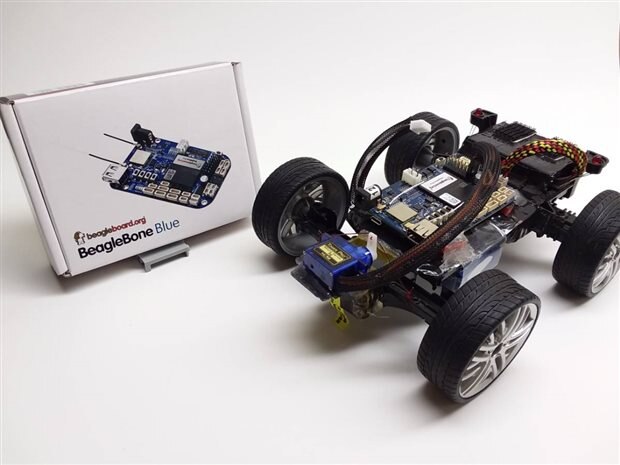

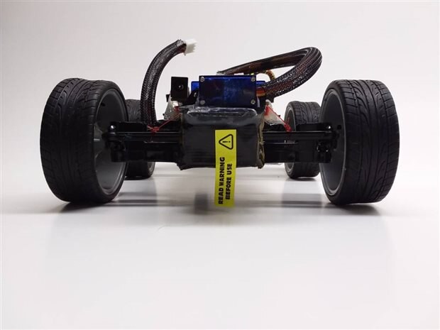

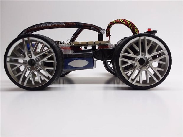

Front View of the BB Blue RTV (Road Test Vehicle)
Side View

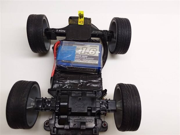

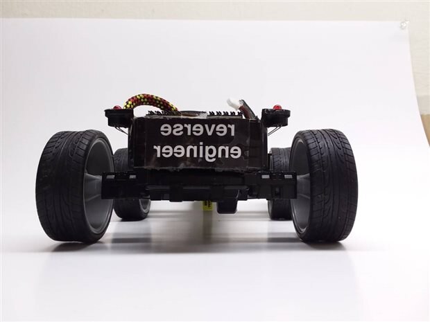

Rear View

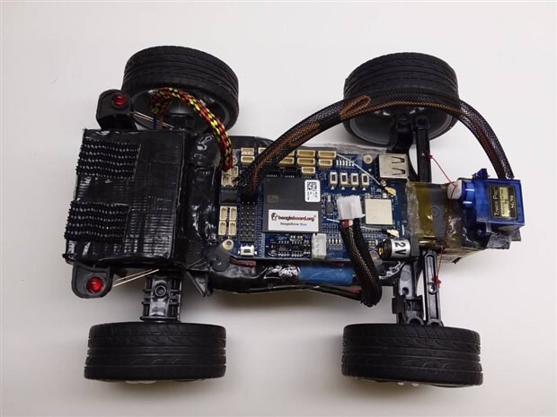

Top View.
Bottom View.

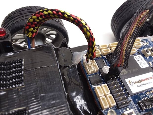

The motor is powered directly from the BB Blue via 2-Pin JST-ZH Connector.
The cable for the steering servo is also connected to the BB Blue.
Conversion of the steering mechanism was an interesting challenge.

    genebren over 8 years ago +2
    Looking good! How were you controlling the car? Did you/will you be using bluetooth to control the car? What sort of range would you expect? I would notice short pauses in some of the dutycycle testing…

    ninjatrent over 8 years ago in reply to genebren
    Thank you. For these tests I used some of the examples provided with the Robotics Hardware API.
    The Beaglebone Blue is controlled by terminal cli via SSH connection.  Range of the WiFi module is impressive and quite fast. These tests were performed in another room separate from the wireless network router. The BB Blue responds as quickly as if it was in the same room. The factory antennas can also be replaced for ones with greater gain.
    Bluetooth would be a method of control that I have not yet considered. Great idea. The BB Blue has an exceptional BT chip.
    I am working towards a completely autonomous system.
    I believe the bit of lag on the duty cycle only occurs during 0.3 or lower duty. This might be due to the resistance from gears in drivetrain. I only noticed during 0.3 duty cycle sweep.
    It's not a perfect vehicle design but the BB Blue has more than met the expectations of these tests.
    Glad you mentioned, there is more GoPro action planned for the future.
    Trent
