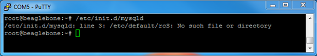

This will download and install MySQL.  Unfortunately, if we try and fire up MySQL:
/etc/init.d/mysqld start
We will see an error:
/etc/init.d/mysqld: line 3: /etc/default/rcS: No such file or directory

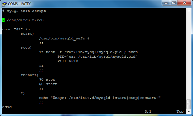

The fix to this issue is fairly easy.  We need to comment out that line 3 in the script:
vi /etc/init.d/mysqld

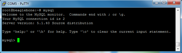

Now when we try and fire up MySQL:
We are successful and we can log into MySQL:

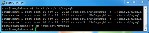

To fix that issue, we need to make some more configuration changes.  First we need to remove some unnecessary links:
rm /etc/rc*/*mysqld

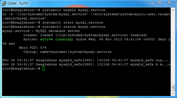

Now we can enable the MySQL service to start at boot and then start the MySQL service:
systemctl enable mysql.service
systemctl start mysql.service
Then we should be able to check the status of the service and make sure that it is running:
systemctl status mysql.service
Now you should be able to restart without getting the log in error and MySQL should be running!

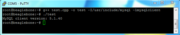

Now, let’s test to make sure that it installed correctly and works.  To do this, create small test script:
#include <mysql.h>
#include <stdio.h>
int main(void)
                printf(“MySQL client version: %s\n”, mysql_get_client_info());
return 0;
This will print out the version information for the MySQL client.  To build it type:
g++ test.cpp -o test -I/usr/include/mysql –lmysqlclient
And then to run it, type:
./test
Now MySQL should be installed on your BeagleBone and ready to use!
