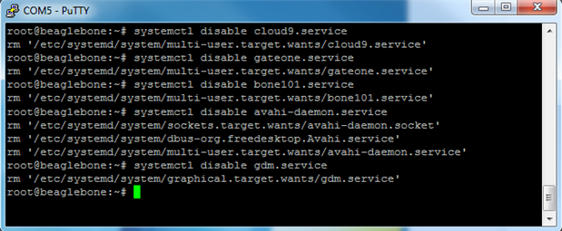

Disable Preloaded Services
The BeagleBone comes with a bunch of preloaded services.  This this makes it really easy to get started, but the preloaded services use port 80, and that is exactly the one that we want to use.  So, we need to disable them, so that we can run on that port. Also, we disable a few extras in order to free up some memory on the BeagleBone.  Here’s how to disable the services (and a link to what the services that you are disabling do, in case you are interested):
For BeagleBone:
systemctl disable cloud9.service
systemctl disable gateone.service
systemctl disable bone101.service
systemctl disable avahi-daemon.service
systemctl disable gdm.service
For BeagleBone Black:
systemctl disable bonescript.service
systemctl disable bonescript.socket
systemctl disable bonescript-autorun.service
systemctl disable mpd.service
Excellent, now that the services are disabled, we need to reboot and the services will be no longer started:
shutdown -r now

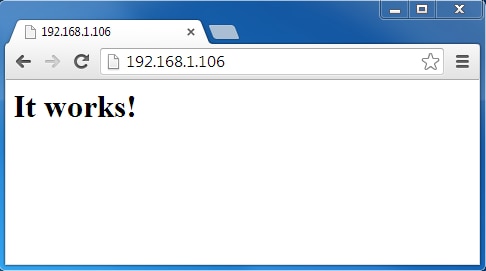

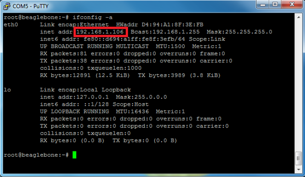

Now, let’s test to make sure that Lighttpd installed correctly.  To do this we need to figure out the IP Address of the BeagleBone:
ifconfig -a
Now on another computer on your network (anything but the BeagleBone), point a web browser to that IP Address, and you should see a very reassuring message:

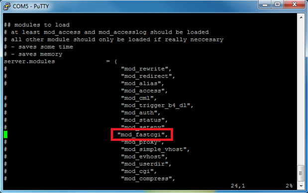

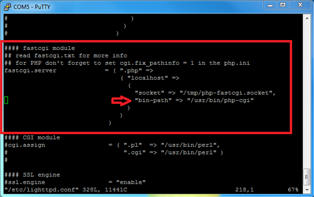

Now we need to configure Lighttpd to use PHP.  To do this, we need to edit the lighttpd.conf config file.  However, before we do this, we need to gather a little bit of information. We need to find out where php-cgi was installed:
which php-cgi
Then we need to edit the Lighttpd config file:
vi /etc/lighttpd.conf
And we need to do two things.  First, we need to uncomment “mod_fastcgi”, which was at line 24 for me:
Then we need to uncomment the fastcgi configuration.  Here we will also need to configure the “bin-path” to point to the location of php-cgi that we found earlier.

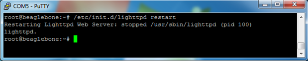

To complete the configuration, we need to restart Lighttpd, so that the configuration file will be read in:
/etc/init.d/lighttpd restart

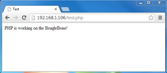

Finally, to test that the web server is working correctly, we are going to create a simple web page:
vi /www/pages/test.php
And type in the following code:
<html>
<head>
<title>Test</title>
</head>
<body>
<?php print(“PHP is working on the BeagleBone!”); ?>
</body>
</html>
To view the web page, go back to the web browser that you used earlier and type in:
<IP Address>/test.php
