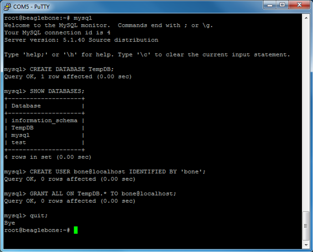

Preparing the Database
The first step is to create a new MySQL database:
CREATE DATABASE TempDB;
Next, we should probably create a new user to log into the database with.  This isn’t strictly necessary, but it is a good idea to not log in as root every time.  Here’s how to create a new user:
CREATE USER bone@localhost IDENTIFIED BY ‘bone’;
Then we need to give the new user (bone) permissions on the newly created database:
GRANT ALL ON TempDB.* to bone@localhost;

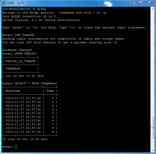

The code is surprisingly straight-forward.  We start by creating the table if it does not exist.  Then we create a parameterized query.  Note that we don’t need to recreate the query or rebind the parameters. This is because we pass a pointer to the bind structure.  So, all we need to do is execute the statement every time a new measurement is taken.
To build the code, use the following command:
g++ tempmeas_initial.cpp -o tempmeas_initial -I/usr/include/mysql –lmysqlclient
Then you can run it using:
./tempmeas_initial
After running the program, we can go over to MySQL and make sure that everything worked like we expected:
That looks good, so let’s move on to incorporating a temperature sensor.

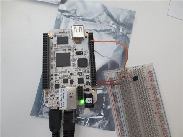

Temperature Sensor
Now that we know that we can put data into the database, let’s set up a circuit to gather that data:
Here we have a MCP9701E temperature sensor connected to analog input #1.  I also did a simple voltage divider to cut the voltage in half since the input voltage is 3.3V and the analog input pins can only handle a maximum of 1.8V.  The sensor output will never be that high (unless it gets really hot), so it is probably unnecessary, but better safe than sorry.
Now we can test to make sure that the circuit is working properly by reading the value that it outputs at:
Older BeagleBone:
cat /sys/devices/platform/tsc/ain1
Newer BeagleBone:
cat /sys/devices/platform/omap/tsc/ain1

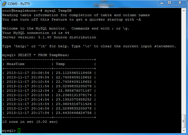

Then we can make a small modification to our code that imports numbers into the MySQL database, so that it now imports in actual temperature measurements.  To do this, we replace the previous for loop with the code below:
// Initialize the temperature sensor
MCP9701E sensor("/sys/devices/platform/omap/tsc/ain2");
// Take a temperature measurement and insert it into the database
for (int i = 0; i < 10; i++)
temp = sensor.GetTemperature();
mysql_stmt_execute(stmt);
sleep(60);
// Close the temperature sensor
sensor.Close();
The full version of the code is attached below.
g++ tempmeas.cpp MCP9701E.cpp -o tempmeas -I/usr/include/mysql –lmysqlclient
./tempmeas
Next we can go over to MySQL and verify that actual temperature measurements are being populated in the database:

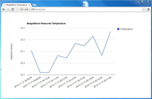

Creating a Web Page
The final piece of the puzzle is to create a web page to display the information in.  To do this, we will use google charts, and slightly modify their line chart example.  All we need to do is add some logic to query the data from the MySQL database:
<html>
<head>
<title>BeagleBone Temperature</title>
<script type="text/javascript" src="https://www.google.com/jsapi"></script>
<script type="text/javascript">
google.load("visualization", "1", {packages:["corechart"]});
google.setOnLoadCallback(drawChart);
function drawChart() {
var data = google.visualization.arrayToDataTable([
['Time', 'Temperature'],
<?php
$con = mysqli_connect("localhost", "bone", "bone", "TempDB");
$query = "SELECT * FROM TempMeas";
$result = mysqli_query($con, $query);
mysqli_close($con);
while ($row = mysqli_fetch_array($result))
$time = $row['MeasTime'];
$temp = $row['Temp'];
echo "['$time', $temp],";
var options = {
title: 'BeagleBone Measured Temperature',
vAxis: { title: "Degrees Celsius" }
var chart = new google.visualization.LineChart(document.getElementById('chart_div'));
chart.draw(data, options);
</script>
</head>
<body>
<div id="chart_div" style="width: 900px; height: 500px;"></div>
</body>
</html>
The change that we made to the google chart example is the addition of the PHP code.  This code will query all of the data in the database and insert it into the web page that is returned to the user.  If the sensor has been running for a long time, this could be a lot of data.  An improvement would be to limit the measurements to the past hour or so. Even better would be to make it user configurable through the web page!  Here we are just focused on a simple example.
Finally, we can visit our web page and check out our results!
