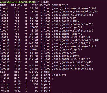

               Insert the uSD on your host device ( In my case it's an Ubuntu 18.04 PC)
STEP2 :
               Identify the partitions using lsblk command.
as you can see in my case the uSD card is mounted as sdb device. unmount the device
umount /dev/sdb1

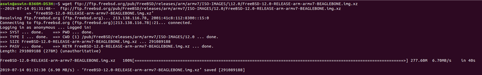

            Download the FreeBSD operating system
wget ftp://ftp.freebsd.org/pub/FreeBSD/releases/arm/armv7/ISO-IMAGES/\12.0/FreeBSD-12.0-RELEASE-arm-armv7-BEAGLEBONE.img.xz

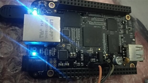

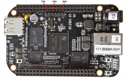

Now comes the booting part. Insert the uSD card into the slot. Wire-up the Serial header to a serial-to-USB converter. Connect the USB to the host PC.
Press Down the "boot" button (next to the uSD card slot) and plugin the USB/DC-JACK to power-up the device. This makes sure that the board is booted from the uSD.

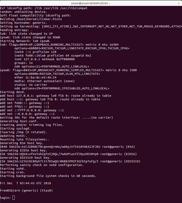

If everything goes well your beagle bone black will start throwing boot information through the serial port.
I used screen to view serial console. You can use your favorite one.
screen /dev/ttyUSB0 115200
You can login with either "root" or "freebsd".
password for root is root
password for freebsd is freebsd

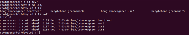

As you know there are 4 LEDs.
cd /dev/led
There are 4 led files. Lets Turn on one LED.
echo "1" > beaglebone:green:usr2
