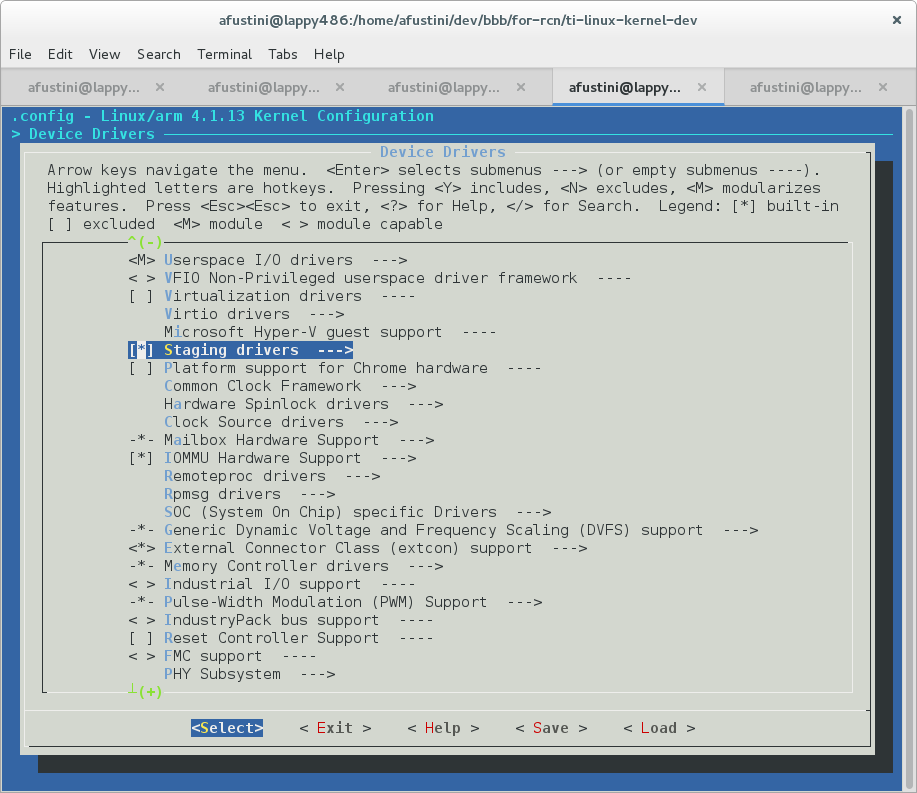

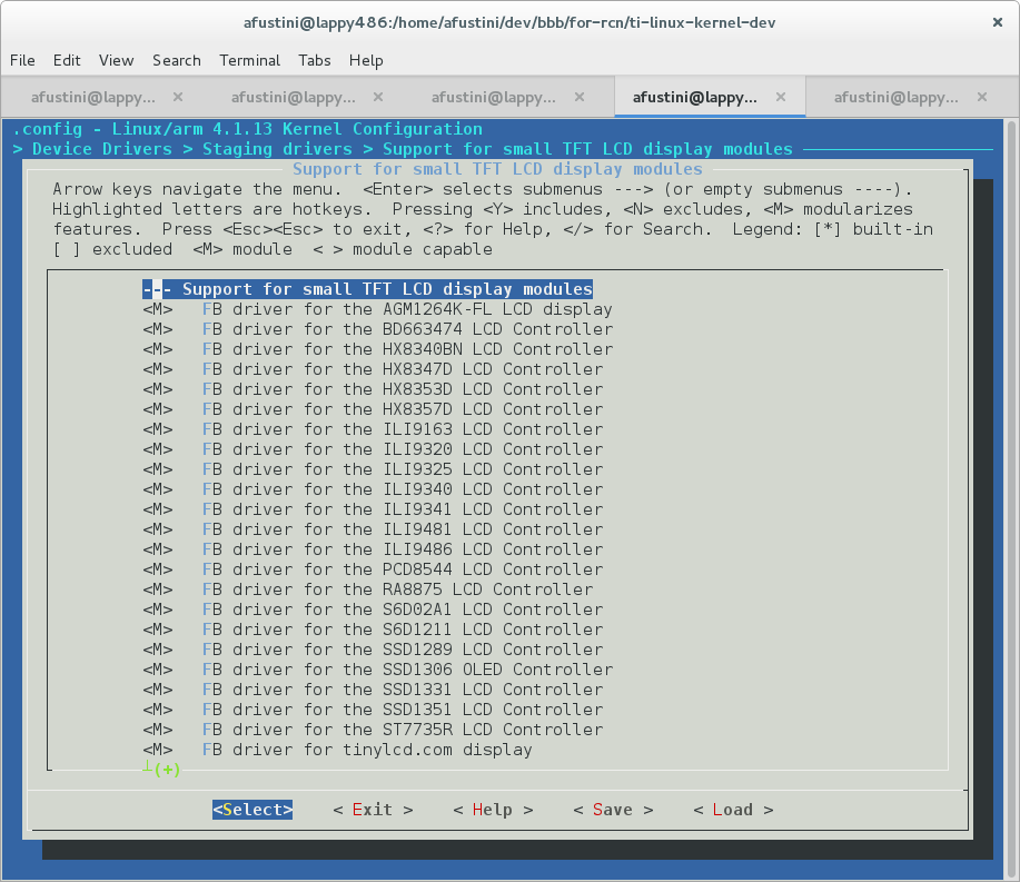

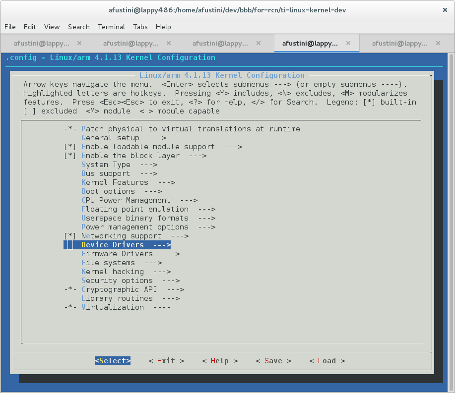

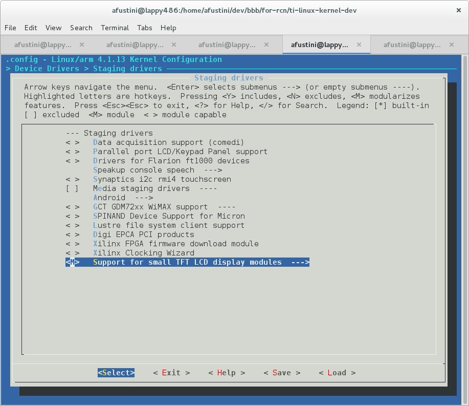

After running for awhile, build_kernel.sh will invoke the kernel config menu.  Enable the fbtft modules located in the Device Drivers -> Staging menu.  Here are photos of kernel config menus:

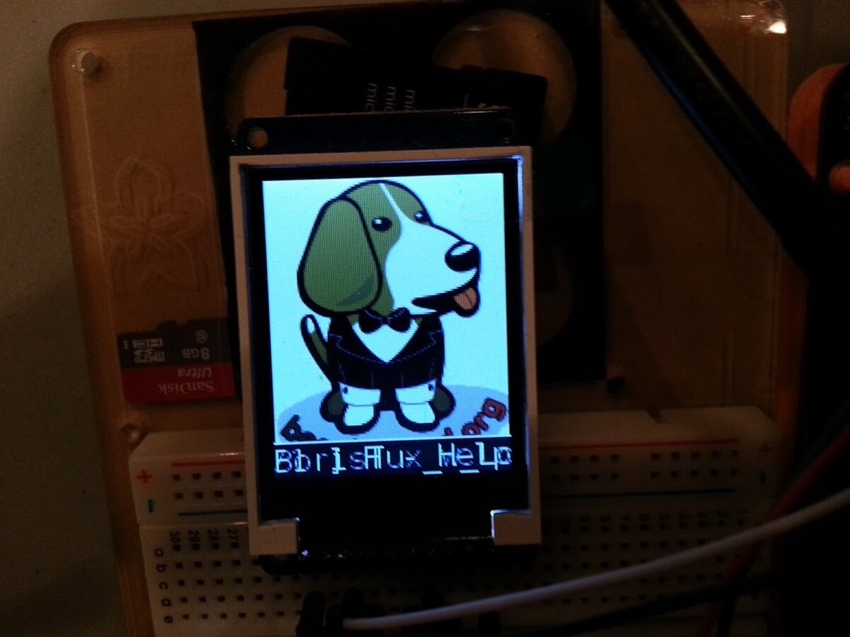

Step 5: Load fbtft driver
Load the fbtft_device kernel module for adafruit18 (Adafruit 1.8" TFT LCD) which will then load the fb_st7735r driver:
bone$ sudo modprobe fbtft_device busnum=1 name=adafruit18 debug=7 verbose=3 gpios=dc:48,reset:60
Install fbi to display image on the LCD:
bone$ sudo apt-get update
bone$ sudo apt-get install fbi
bone$ wget 'http://beagleboard.org/static/uploads/BorisTux_w_Logo.png'
bone$ sudo fbi -d /dev/fb1 -T 1 -a BorisTux_w_Logo.png
