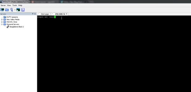

To test the circuit we need to access our BeagleBone Black via SSH. I covered how to do this in the BeagleBone Black RSS News Reader tutorial, but will post it here as well.
To access the BeagleBone Black via SSH I will be using a terminal for Windows called Putty, as well as an add-on called MTPutty, which allows me to run multiple putty instances from within a single tabbed interface. Both Putty and MTPutty are available for free, and take just a few moments to download and install. Chances are, if you are reading this, you already know how to use Putty. If you are using a Mac you can simply use the built-in Terminal to access your Black Via SSH. To connect to your Black, you need to enter the following credentials.
With these settings configured, click ok and then double click the BeagleBone Black name in the server list. This will open up a new terminal tab and you will be prompted to enter a username. Unless you have modified the root user, you should enter root as the user name.
BeagleBone has made it easy here as there is no password and after entering the username, the connection will finish, and you will be placed in your "home" directory.

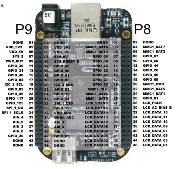

Now that you are SSHed into the BeagleBone Black we will need to prepare GPIO 67 (P8:08). The pinout diagram can be seen below.
Before we get started with testing, lets take a moment and talk about how the BeagleBone Black's GPIO pins are addressed by the Linux-based Debian operating system. The BeagleBone Black addresses its GPIO Pins by reading the contents of files which are located in the sys/class/gpio directory in the board's operating system. The most basic functionality is to write the pin high or low, and is what we will be doing in this tutorial.
To use a GPIO Pin you first need to tell Debian that you are going to use a particular pin in a specific GPIO header. The following code uses GPIO 8.8 as an example, but any GPIO Pin can be accessed by creating these files. Enter the following commands into the BeagleBone Black's terminal.
The first thing we need to do is create a new directory called gpio67 in the /sys/class/gpio/sys/class/gpio directory.
echo 67 > /sys/class/gpio/export
