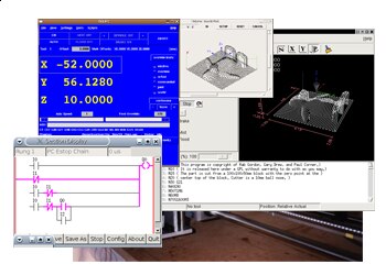

Our first idea was to leverage existing open source CNC software called LinuxCNC (formerly EMC2).  Old PCs with parallel ports can be used to build a CNC controller with LinuxCNC.  We like this low cost approach to CNC and felt makes sense to replace a builky PC with a single board computer like the BeagleBone Black .
source: http://www.linuxcnc.org/
We discovered there was already a pre-built SD card image for the original BeagleBone.  However, it utilized the Linux 3.2 kernel whereas the BeagleBone Black (BBB) currently requires the 3.8 kernel.
I did some research which I documented in this thread: BeagleBone LinuxCNC blog.  I then discovered one of the developers is a Community member, mhaberler, and he explained the current effort to port LinuxCNC to the BeagleBone Black and 3.8 kernel.  He also pointed out the BeagleBone LinuxCNC which had a relevant post:

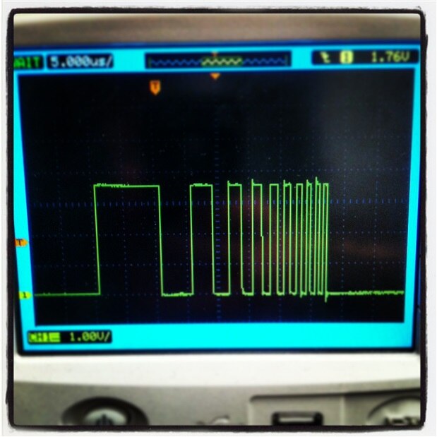

Elias uses the BeagleBone PRU to handle steppper motor acceleration and send step and direction signals to TI DRV8825 stepper motor driver ICs :
source: http://hipstercircuits.com/accelerated-stepper-motors-on-beaglebone/
