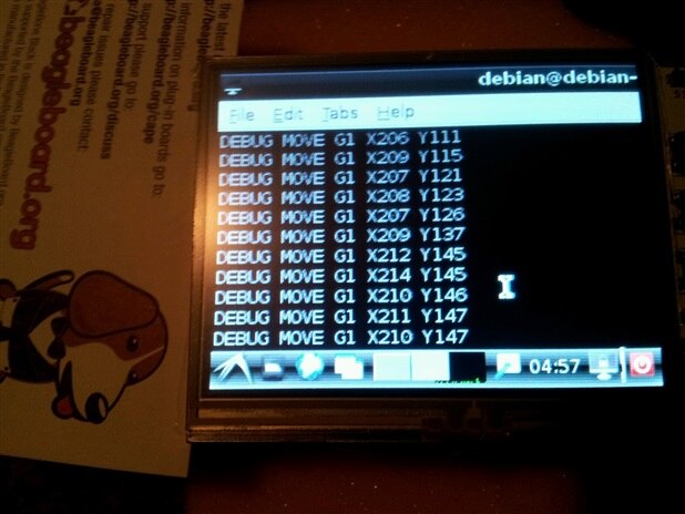

Following my last update, we decided to use TinyG to do motion control for our Pick-n-Place machine.  The BeagleBone Black needs to send the appropriate g-code over the serial port to tell the TinyG what movements to make.  One of our team members, Ed Bennett, had the idea of using the mouse to control the PnP machine while we continue to develop it.  For now, we need "exercise" the X-Y gantry to see how well it works before mounting Ed's vacuum nozzle head which has Z-axis and alpha-axis (rotation).
Porting PyQt demo
Ed developed a PyQt demo for mouse control of PnP gantry on his Linux laptop.  Bonnie King and I then worked on getting Ed's program working on the BBB.  It turned out to be an issue that the code seems to use Qt3 classes.  It worked on Bonnie's Fedora laptop with Qt3 installed.  However, neither Angstrom, Debian 7 (www.armhf.com) or Ubuntu 13 (www.armhf.com) had Qt3 available in their repos.
We ended up rewriting the program for Qt4 based on various PyQt for Qt4 examples (using Debian 7 as it was last distro we tried when still search for Qt3):
https://github.com/pdp7/bbqt/blob/master/pnpcntrl.py
The code is messy right now, but it will writes g-code to the serial port (via PySerial) per mouse movement.  At first I thought there was a problem, as it was really slow, but I realized after awhile it was because I running it remotely via X.  I put my 4.3" LCD touchscreen cape on the BBB and installed LXDE desktop env into Debian on the BBB.  It then drew at a normal speed no problem - d'oh image  I could also draw using my finger on the touchscreen.  The photo attached looks crude as I was drawing points with a large pen at that point before going to drawing lines with a finer pen.

Here's a video of the gantry running under mouse control.  We taped a marker to the head and used a pizza box to simulate the PCB to determine if the machine's X & Y were calibrated properly:
Here's a still photo from the process:
We learned we needed to adjust the size of the canvas in Qt and also scale the mouse coordinates to the dimensions of our machine (about 10" travel on both the X & Y).  Luckily, I was able to use the LCD4 cape directly to edit the (tiny) Python code:
Ed B (right) and Dan D (left) decided it would be better if we tried to draw a square exactly:
We wrote exact g-code for a square instead of using the mouse and it worked well:
We were very proud to see our little PnP bot's artistic taste move from abstract to realism image

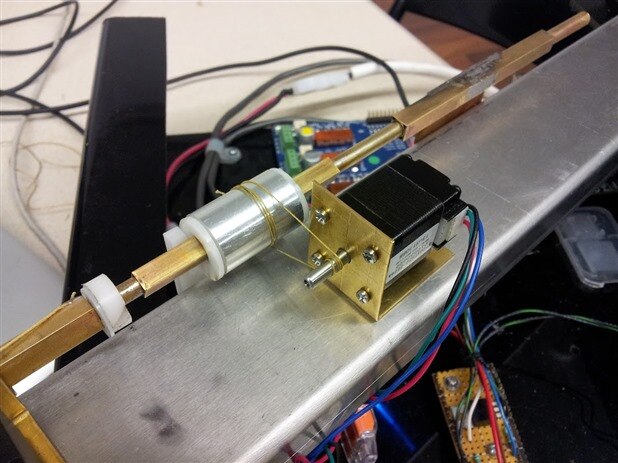

Our next big task is a mechanical one: mounting Ed's Z-axis + alpha-axis head onto the PnP gantry.
In my next post, I'll describe the process Ed went through in design the Z-axis and alpha-axis and how he machined the parts in the device

    Hi - thanks, that's an interesting idea to change the pen to a laser pointer until our real head is mounted.
    I'm going to make another post shortly that covers more of the mechanicals.  Ed's head has the Z-axis and also rotation (theta).  A tube can be connected at the top going to a vacuum pump. The valve will be controlled by a solenoid that can be switched on and off from a transistor connected to the TinyG (certain G-Code will then actuate it when needed).  If that doesn't work, then we can interface to transistor to an output pin on the BBB.  When necessary, the Python program and toggle the BBB pin in between writing G-Code commands to the serial port (which goes to the TinyG).
    For the feeder, we have a piece a delrin (which is like a hard plastic) which another member had machined with 8mm slots in it (I think there are 10).  Cut tape with surface mount components will fit in the slots.  The slots are about 6" long and an acrylic covering would go over the top to hold the tapes in the slots.  One side of the slots wouldn't be covered so the PnP head pick the components out of the containers in the tape.
    Hopefully some photos and video in my posts will make it clearer.
