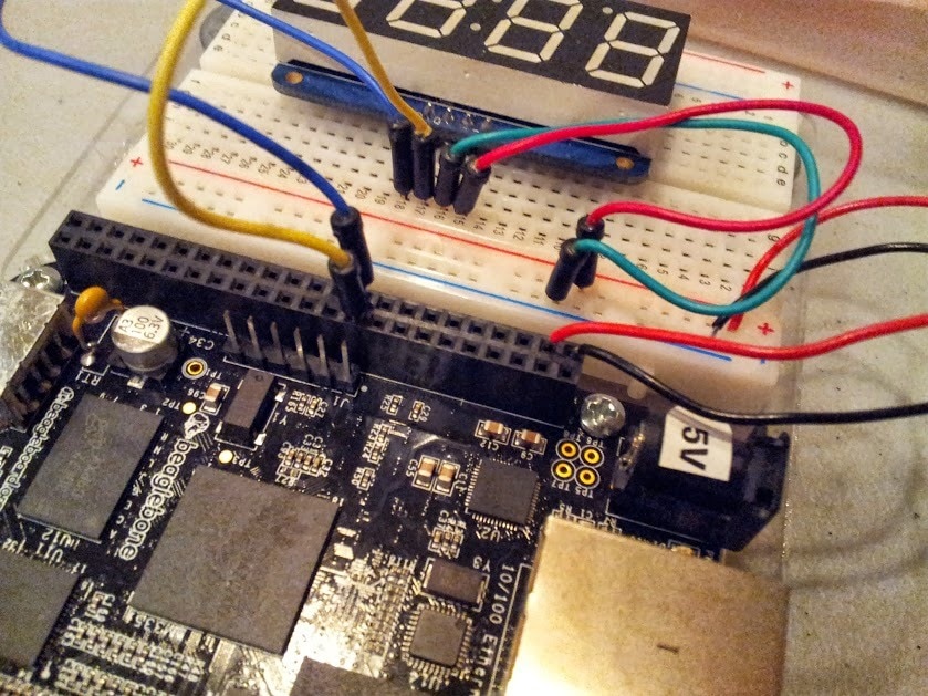

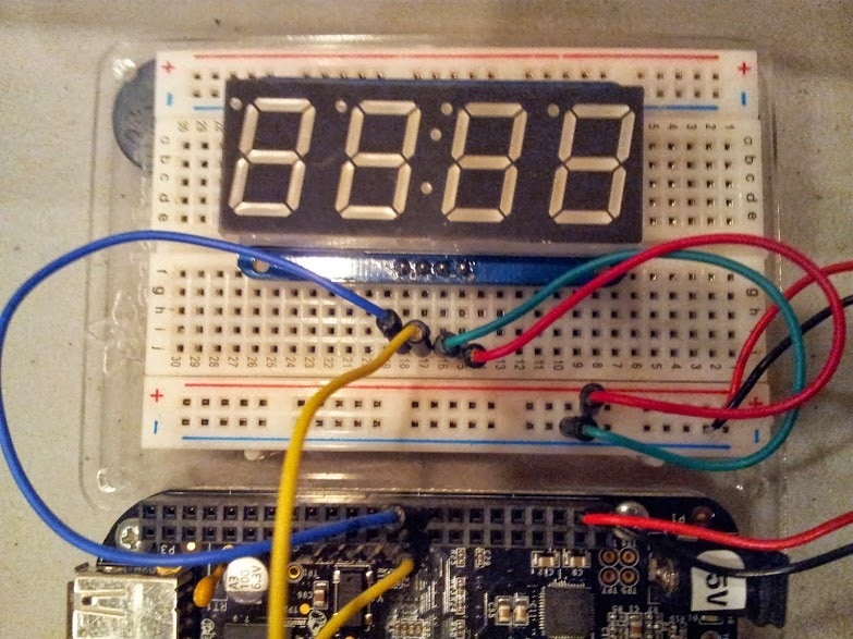

Adafruit's 7-segement LED "Backpack" display turned out to be quite easy to interface with the BeagleBone Black (aka BBB) .  "Backpack" means the 7-segment display has a chip on the back side which allows it to be controlled via I2C.  The display just needs power (3.3V) and ground along with the 2 pins on the BBB for I2C data and clock signals.  Here's how I have it wired up on top of an Adadfruit BeagleBone Black prototyping plate :
