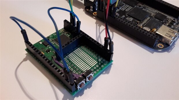

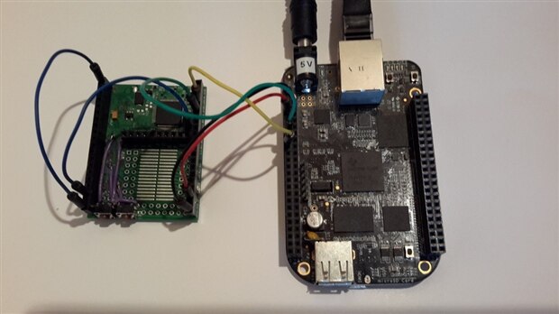

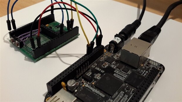

The next step is to connect the Espruino to the BBB, and make sure the Espruino is wired up to enable the serial bootloader as follows:-
Espruino BOOT0        >    Espruino 3.3v
Espruino BOOT1(PB2)    >    Espruino GND
Espruino PA9(tx)        >    BBB P9 – 11 (rx)
Espruino PA10(rx)        >    BBB P9 – 13 (tx)
Espruino GND         >    BBB GND
Espruino 3.3v            >    BBB 3.3v
*the BOOT0 pin is labelled BOOT0 and is near the STM32 device.
It's probably best to leave connecting the 3.3v supplies until just before you start programming in case the bootloader times out.
