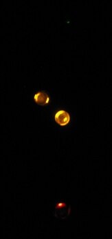

So, I set about to build a way to use the BeagleBone to light up a sequence of LEDs to show the route to go up the wall.  To do this, I followed this great tutorial on how to use a 74HC595 shift register.  The tutorial was written for the arduino, but the circuit diagrams are easily transferrable – all that changes is what GPIO ports to connect to.
The code is a bit different though.  I was unable to find an analogous function for shiftOut, which seemed to be the heart of the program.  After a couple of attempts to write my own, I decided to just hard code the routes into the program and include an easy, medium and hard route.  Here are what the three routes look like:
EasyMediumHard
Here’s a quick video of the step up:
