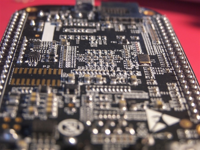

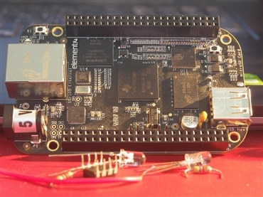

As soon as the Rev C version of the BBB became available, sales went through the roof – as many will remember, during parts of 2014 it was almost impossible to buy one. This was largely due to the fact that it now had enough space for the pre-installed Debian, plus the increased processor speed and RAM. The huge, dual 46-pin headers helped, too – compared to other single-board computers this size, it's hard to believe that you can have this many pins brought out for user applications!

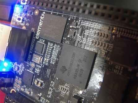

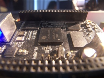

Upon opening the box, I was immediately impressed with the board. I must admit, I'm a bit of a TI fanboy, so that helped – but the black solder mask and the rounded corners made it look sleek and sexy. I eagerly fired it up, and was impressed with the boot time into Debian – one of the effects of having the OS in eMMC memory. Everything just worked out of the box – SSH was set up, plugging the USB into my laptop revealed a serial terminal, a built-in web server (which we'll talk about in a bit!) and an emulated USB flash drive! Clearly this was designed with development in mind. Having a serial terminal over USB is a great move – though there is a serial header on board, you don't even need to use it! This can make a big difference in the ease of troubleshooting and/or development. If SSH is not an option, plugging it into USB means you can work on the board with literally no other connections – no monitor, keyboard, DC input, Wi-Fi, Ethernet, nothing. Just a single USB cable. Now that is how it should be done! This is even more critical as there is only one USB host port, meaning to have more than just a keyboard plugged in you need a USB hub. For most developers this isn't an issue, but it's annoying to have this extra box hanging off of the board. I've found the best way to work with the BBB is to have it plugged into a laptop, with an Ethernet cable for internet access (if you have a cable nearby – otherwise, you can use the empty USB port for Wi-Fi!).image
