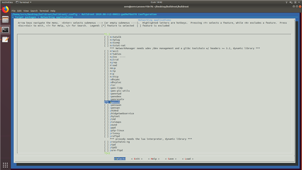

Hello everyone,
As I said, the boot hangs very long time about 1-1.5 h at
     Starting dropbear sshd [     2.692626] random: uninitialized urandom read (23 bytes read)
     OK
Or when there is openssh instead of dropbear, it hangs at
    Starting Network: OK
Why is this? How can I solve this?

    criminus over 7 years ago in reply to shabaz
    Hi,
    Thanks for your reply. Board is BeagleBone Black.
    I used Buildroot.
    There is what I did:
         $ make beaglebone_defconfig
         $ make menuconfig
    Then I selected openssh on Target Packages/ Networking applications, and saved.
    Then I build.
         $ make

  • clem57
    clem57 over 7 years ago in reply to criminus
    criminus can you rebuild without SSHD to verify the rest of the system?
