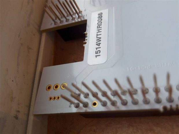

I bought a Circuitco Weathercape and it says Rev B on the board. I use Debian Wheezy and the command uname -a on my beaglebone black gives
Linux beaglebone 3.8.13-bone47 #1 SMP Fri Apr 11 01:36:09 UTC 2014 armv7l GNU/Linux
The page at the following link says
CircuitCo:BeagleBone Weather - eLinux.org
Note: Revision B is now fully compatible with BeagleBone Black.
Revision B:
- The Weather is now fully supported with BeagleBone Black using kernel release 3.8.13-bone45 or later.
- Remove the conflict pin between revision A and the BBB's eMMC (GPIO1_3)
- Pin 6 of P1 connector is removed from the board to eliminate the eMMC signal integrity issue when using Weather Cape with BBB.
Everything should be ok, and it works fine when I boot from microSD. However, when I boot from eMMC, I get the following errors:
bone_capemgr bone_capemgr.9: slot #4: BB-BONE-EMMC-2G conflict P8.6 (#1:BB-BONE-WTHR-01)
bone_capemgr bone_capemgr.9: slot #4: Failed verification
bone_capemgr bone_capemgr.io 19: loader: failed to load slot-4 BB-BONE-EMMC-2G:00A0 (pr)
and the beaglebone freezes up.
What is going on? I have rev B and a new enough kernel?

    The message says conflict between eMMC and Weather Cape on P8.6 pin
    That is pin on right most row 3rd down from GND. Double check that the eMMC OS is same as on SD card.

    The cape came with pin 6 already removed (see image)
    The kernel on the SD card was
    Linux beaglebone 3.8.13-bone70 #1 SMP Fri Jan 23 02:15:42 UTC 2015 armv7l GNU/Linux
    I flashed the beaglebone with the image from the SD card so the kernels are exactly the same. Still no luck.
