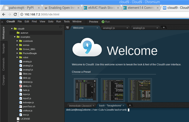

  • mp2100
    0 mp2100 over 7 years ago in reply to shubham1997
    Hmmm, good questions.  I should document my testing more thoroughly.
    For which image, I used the newest image from beagleboard:
         BeagleBoard.org - latest-images
         At this time the latest is named    Debian 9.5 2018-10-07 4GB SD LXQT
    I did not use the external power source, I connected the BBB using a USB cable to my Linux laptop, and used the included Cloud9 interface to communicate with the BBB (web browser at 192.168.7.2:3000)
    I did use a 16 GB SD card with the 4 GB image from beagleboard.org.  I expanded the image so I could use the full 16 GB, so yes, that gives me more storage.  But is your question about using the SD card as external storage instead of a boot device?  If yes, then I would answer that I'd put a USB flash drive into the BBB USB port for that purpose.
    For automatically executing a script to illuminate a pattern of LEDs, one answer for the BBB is to use the node.js feature built into the cloud9 IDE.  There is an autorun folder, and when you copy a node program into there, it will run at boot up.  Wire the LEDs to the plentiful GPIO on the beaglebone, test your node.js program, and copy it there when ready.
