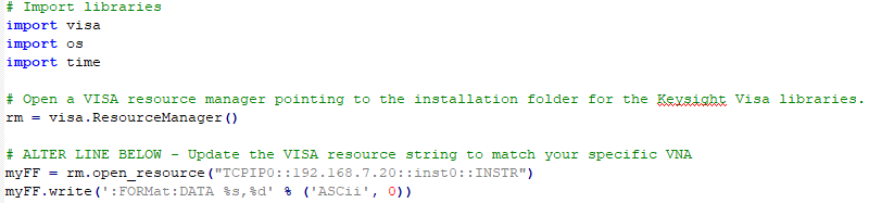

    When I try to load the following into cloud9, I get the following error.  How do I get the dang module to load?
    # Import libraries
    import visa
    import os
    import time
    # Open a VISA resource manager pointing to the installation folder for the Keysight Visa libraries.
    rm = visa.ResourceManager()
    # ALTER LINE BELOW - Update the VISA resource string to match your specific VNA
    myFF = rm.open_resource("TCPIP0::192.168.7.20::inst0::INSTR")
    myFF.write(':FORMat:DATA %s,%d' % ('ASCii', 0))
    Traceback (most recent call last):
      File "/var/lib/cloud9/PILOT_Test/FFtransfer.py", line 8, in <module>
        import visa
    ImportError: No module named visa

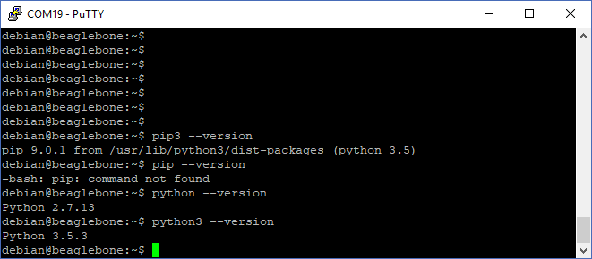

    It looks like you don't have python-pip installed but you do have python3-pip installed. If you're intending to use Python 3, then you can use that.
    I didn't realize BBB is Debian based, this makes it veryvsimilarsto the RPi.
    I'd suggest you do something like:
    sudo apt-get update
    sudo apt-get upgrade
    sudo apt-get install python-pip
    Then run the pip commands as listed before to install pyvisa.

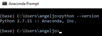

    I personally don't care which python I use.  The code was originally coded in py2.7 apparently as that is what is on my PC.
    I just need to get the BBB to load my code and at present it is not loading/recognizing my visa module.

    You may not care, but the computer might! There are subtle differences in the syntax between Python 2.x and 3.x which means they are not always interchangeable. The most glaring example is print - in 2.x, you could write print 'Hello', whereas 3.x requires print('Hello').
    If your code is not impacted by the changes, you could try installing pyvisa on Python 3.x with pip3 rather than pip and run python3 scriptname.py rather than python scriptname.py
    Regardless, did you run the commands in the last post that I suggested? That should upgrade all packages and install pip for Python 2.x so you can then run the commands to install pyvisa for Python 2.x as well.

    Agreed.  I know there are definitely differences.  What I mean is that I'll code it either way, I just want it to work...  image
    It is not the PC I have issues with, the code runs fine on the PC but I cannot get it to load on the BBB.  The visa module is the only error it throws when I try to run/compile it.
