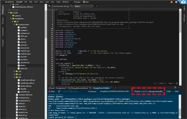

  • Sean_Miller
    0 Sean_Miller over 6 years ago in reply to prathamesh12
    In the cloud9 environment, you need to set the runner to the beagle make file.
    see ya
    sean
  • prathamesh12
    0 prathamesh12 over 6 years ago in reply to Sean_Miller
    Hi sean,
    Cloud9 classification example is running absolutely fine.
    I am trying to compile other examples provided in /usr/share/ti/examples/tidl directory.
    Thanks.
    Prathamesh
