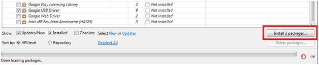

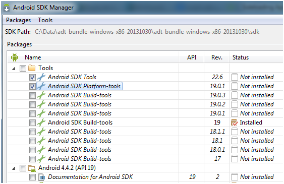

   4. There are three key software packages to install
    1. Android SDK Tools and Android SDK Platform-tools (Under “Tools” at the top of the list)
          b. Google USB Driver (Under “Extras” at the bottom of the list)
Fullscreen contentimage_30366.html Download
<html><head><title>Jive SBS</title></head>
<body><font face="arial,helvetica,sans-serif">
<b>Error</b><br><font size="-1">
An general error occurred while processing your request.
</font></font></body></html>

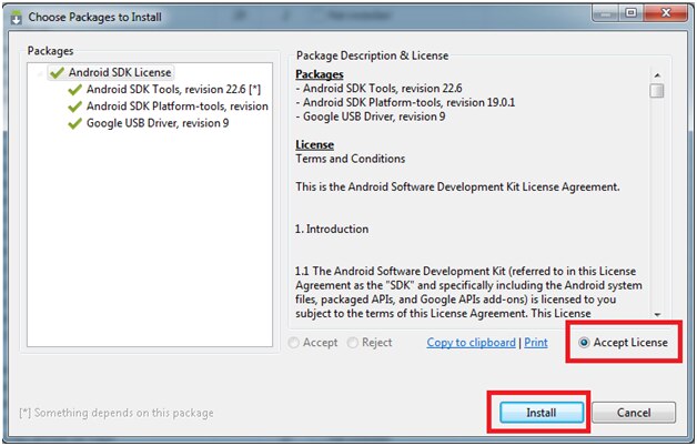

   5. Then click on the Install button
   6. It’ll then ask you to accept the license, and click on Install again
   7. The SDK Manager will then download and install the tools and drivers necessary.

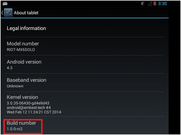

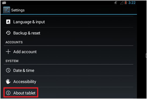

To enable debugging:
  1. Go to Settings
  2. Scroll down to the bottom and click on About Tablet
   3. Scroll Down to the bottom to Build Number
   4. Click on Build Number 7 times. After about 3 clicks you’ll see a pop up saying you’ll be developer after only 4 more clicks.
   5. After getting the message about enabling the developer options, go back to the main Settings page.
   6. You’ll now notice there’s a “Developers options” section at the bottom

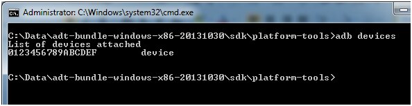

Part III: Connect and Test

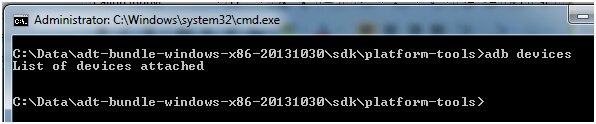

After the SDK Manager is done downloading and installing the moment of truth awaits. Getting the USB drivers to connect to an Android device correctly is where most of the headaches happen.
Connect a USB cable between your computer and the mini-USB port located next to the Ethernet port (do not use the one next to the camera connector). If all goes well it’ll enumerate properly and you’ll be able to make a debug connection.
To test out the connection, open a terminal prompt inside the platform-tools directory at <ADT install directory>\adt-bundle-windows-x86-20131030\sdk\platform-tools
If you type “adb devices” you should see a device connected:
However if you type “adb devices” and it comes back with no devices, then the driver needs to be installed manually:
The driver can be found in <ADT install directory>\adt-bundle-windows-x86-20131030\sdk\extras\google\usb_driver
Typically you can go to the Device Manager, find the board (it should enumerate as something even without the driver), right click on it, and go to Properties > Update Driver > Browse > Let me pick > Computer > Have Disk > Browse > and navigate to the folder listed above to point it to the correct driver.
If you have trouble, check out the following links:
Riotboard USB driver for Windows (Eclipse)
Android USB Driver Help Page
Walkthrough of steps
You can also type “adb shell” to enter the Android shell.
The first time you successfully connect to the board via the Android debugger, a message will pop up in Android asking if you would like to allow USB debugging. Click on OK to accept.
