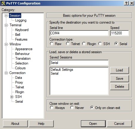

Now what we need is software to receive the data. I recommend PuTTy because it's free and you don't need administrative rights to run or install it.
Portable: PuTTY Portable | PortableApps.com - Portable software for USB, portable and cloud drives
Install:     PuTTY: a free telnet/ssh client

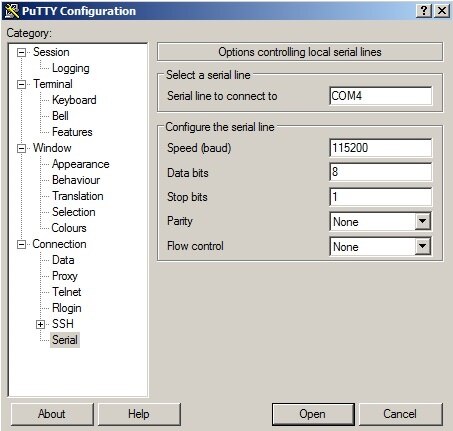

When you run PuTTy you'll have to setup the COM port (as discovered via device manager instructed above) and also the flow control, data rate, etc:
The key settings to take away from here are the "Speed (baud)" and the "Flow control". If there's anything set incorrectly, when you click 'Open' on the "Session" tab you're going to get a garbled mess or unknown characters.

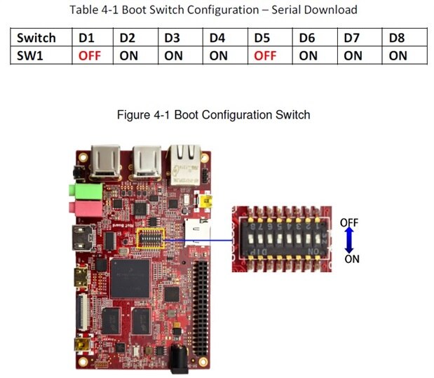

Now with the RIoTboard turned off, we need to set the DIP switches, according to section 4.1 of the User Manual, we set it to "Serial Download Mode":
There's one final setup step and that's to connect the USB cable which came with the board.
Confusingly there are two Mini-A USB ports on the RIoTboard, one has a specific function in that it functions for OpenSDA.
The port we're interested in is sat between the MicroSD and Ethernet (RJ45) port on the board, which if you look at the RIoTboard image explaining the DIP switches, is in the top right of the board, next to where you connect the debug serial cable. Once these are connected you'll need to turn on your RIoTboard.
