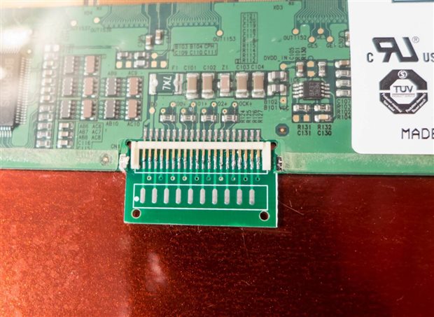

This is what the LCD connector looks like on the back of the LCD panel. Different model LCD panels may have a different connector:
The connector has 1mm pitch pins, however it is extremely hard to crimp a mating connector without the correct tool. Therefore the metal shell was removed (gently ripped off with an old pair of wire cutters):
Then, the breakout board was directly soldered onto the pins:
This is eventually where I needed to get to:
More on that later, but it is probably easier to solder these wires on first (the wires are discussed next), and then solder the breakout board onto the LCD panel connector to end up with the result seen in the photograph above.

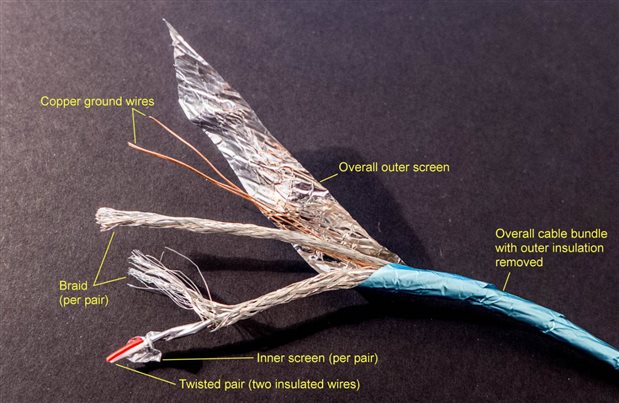

Selecting Cables
LVDS signalling is carried over pairs of wires. The communication from the RIoTboard to the LCD panel is carried over four pairs of wires. The cable is fairly critical. One option is to try Ethernet cable however in the end I decided to use the internals of a SATA cableSATA cable. The photo below shows the insides of the cable with the plastic insulator stripped off. The cable has two pairs of wires. The outer screen and braid was removed, leaving just the twisted pairs with inner screen intact.
Some recommendations when creating the LVDS signalling connections are:
  1. Keep the cable lengths all exactly identical
  2. Untwist the bare minimum at each end, and keep the remainder twisted (don’t over-twist the remainder either; keep it exactly as it was)
  3. No sharp bends; try to make them curved
Once the connections were made, the copper ground wire was twisted around all the pairs to keep the screens all at the same voltage, and to keep a tidy bundle.
