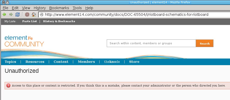

http://www.element14.com/community/docs/DOC-65474?ICID=knode-riotboard-prodspecs has a link for schematics, clicking on it results in:
Perhaps either remove the restriction, or remove the link.

    Sorry about that-- fixed now!
