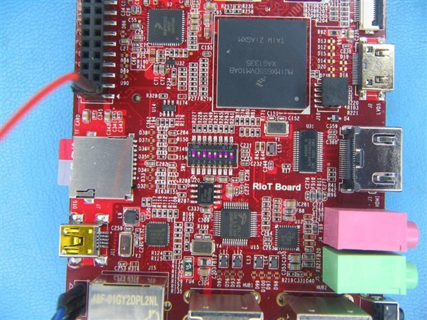

    0 e14 Contributor over 12 years ago in reply to e14 Contributor
    Switch settings:
    Fullscreen 6648.contentimage_176412.html Download
    <html><head><title>Jive SBS</title></head>
    <body><font face="arial,helvetica,sans-serif">
    <b>Error</b><br><font size="-1">
    An general error occurred while processing your request.
    </font></font></body></html>
    or maybe this is better with them highlighted?
    uSD Card:
    Fullscreen 0447.contentimage_176414.html Download
    Card installed here:
    Fullscreen 7384.contentimage_176415.html Download
    # fdisk -l /dev/sdc

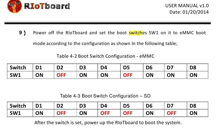

    then powered down, reset the switches to the default eMMC boot settings from table 4-2 in the manual, removed all SD cards, powered it back on and I instantly get the U-Boot 2014.04-rc2...  It obviously doesn't boot fully as it's still missing a kernel and filesystem, but it seems there's nothing particularly special needed.
    So possibly your board does have a problem...  Or it'll be something so simple that you can't see it when it's staring you in the face... We've all been there image

    Then removed the SD-Card put the switches to 2-Off 5-Off.
    And... nothing.
    No response at all.
    That happens if you have the switches set to boot from a device that doesn't contain the correct data. As far as I can tell, there's no fallback to a different device within the on-chip boot rom (however looking at the boot flow charts in section 8.5.3.2 of the ref manual... well, it's complicated.. easily possible I'm missing something), other than 'Manufacture Mode' which would allow boot from a full size SD card (or, seemingly from the OpenSDA).
    Building a full table of what the switches do is complicated by the fact that changing one switch from off to on might change the function of another three switches. Simplistically, with D1 On, D2 Off, you have D4 on for eMMC mode, off for SD mode, then D7 & D8 pick one of four possible SD interfaces.
    So, are you using a full size card in J6 on the underside of the board ?  Or a uSD in J7 on the top ?  You'll need to change D7 & D8 to match.

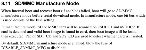

    SD & eMMC are very similar, it's quite possible you can boot from an SD card while D4 is set to eMMC mode, assuming D7 & D8 have picked one of the SD slots. (or you're using a full size SD card and booting in mfg mode)
    You're making me wonder if there's a problem with the physical switches themselves.. So even though you've turned a switch on, it's not physically shorted the two pins. Matthias was having similar problems that could probably be explained by this.  If you have a multimeter, it should be easy enough to check if anything like that is happening.
    Part of the reason I'd posted the photos was to make sure there wasn't something like some boards having the switches mounted in reverse causing counting from the wrong end or on/off reversals.

    I suppose it's also possible that the eFUSEs have been blown on some boards in a way that overrides some switch settings, but hopefully that's something we don't have to worry about.

    All dip switches are on except for D2 and D5 and it boots from the card. You said when D4 is set to on it´s in eMMC mode and it then can boot from the SD card in mfg mode. That´s the case I suppose.
    So if you have only D2 & D5 off, then it would seem that as long as what's at 1KB in the eMMC isn't seen as being a valid boot image then it'll try uSDHC1 which is connected to the OpenSDA and uSDHC2 which is your full size SD card.  Using this mode obviously isn't ideal as it's using 1bit rather than 4bit to access the card, so it'll be slower, but presumably u-boot will then use 4bit mode and you're fine from there.
    I wonder why you were having problems with the switches set differently then.  Forgetting about actually booting to linux for a moment, it should be simple to get the u-boot prompt on any of eMMC, SD, uSD by just writing a u-boot.imx starting at 1KB, there doesn't appear to be anything special needed other than that. Once you have u-boot loaded it's a relatively simple task to script what you need, even booting from the network.
