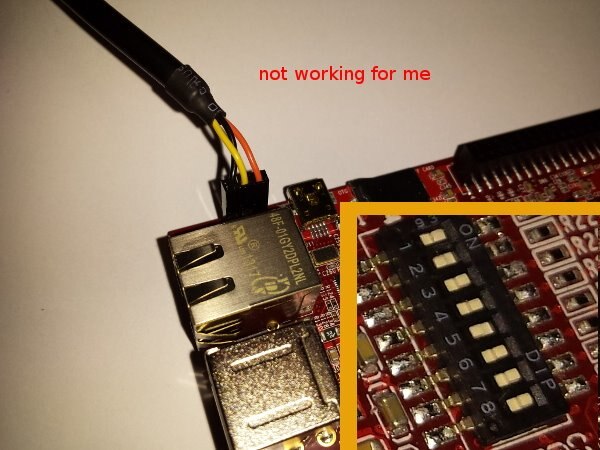

Hi,
i didn't got a serial connection running yet - no output.
My setup was like in the blog post with the same cable.
blog post:
Impressions on the RIoTboard and changing its Operating System in Windows
Same cable with my raspi works great.
Do i need to setup something first?
Steffen

    It should work directly. As soon as you pressed the reset button it should give you some output.
    Maybe you switched the txd with the rxd pin? Then you wouldn´t get any response.
    0 e14 Contributor over 12 years ago in reply to radiatortwo
    Thanks for the hint Otto.
    Unfortunately it didn't help. I also tried with 2 different boards - one with factory settings and one with Ubuntu on EMMC.
    No luck image
    Cable: TTL-232R-RPi (FTDI-Chip)
    black - GND
    orange - TX
    yellow RX
    Also tried other cables with one of the riot-boards: TTL-232R-3V3, CR-409202
    Do i need to set any jumpers to enable serial interface?
    0 e14 Contributor over 12 years ago in reply to e14 Contributor
    No jumpers needed, it should just work right out of the box at 115200 baud 8-N-1, From your photo, I think the red/orange cables should be swapped.
    Does Android/Linux come up? I just want to make sure the switches on SW1 are in the default position. If you see Android/Linux, you should see output on the terminal.
    I used this cable with no problems: http://www.embest-tech.com/product/extension-module/uart8000-u.html
    Riot (J18):                Cable:
    1  (TXD)                     Green (RXD)
    2  (RXD)                     Red (TXD)
    3 (GND)                      Black (GND)
    Yes, Android / Linux come up. I also tried to swap rx / tx (yellow and orange in my case), but no success.
    I will do further testing image
    Ah, you are right - i switched yellow and orange and it's working image
    Not sure why it didn't last time image
