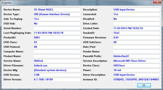

Hello,
I am unable to get the SVN2591 release from Embest to work with the older Mfgtool available for download.
I have updated the files with the correct name of the Image files.
There was a problem with the name for uboot image but I have changed that and overwritten the files.
Still only the older image works but the new image just reaches to 'Jumping to OS' message and then hangs.
If I do the Yocto Release SVN2777 then it works, but I would need ubuntu as yocto build does not include the full feature debian.
Kindly help me out.

  • radiatortwo
    0 radiatortwo over 11 years ago
    Have you also updated the UCL2.xml file?
    It defines how the image should be flashed. (partitioning, writing, initialising the different stages and so on.)
    But as always the log file would help to find the error.
  • bose
    0 bose over 11 years ago in reply to radiatortwo
    Yes, Actually the name of the uboot image was not correct in the UCL2.xml file. Hence I have tried the procedure by updating the name.
    And copying the Image files to both the 'OS Firmware' and 'files' directories inside the profile directory.
    Then I changed the name of the parts in the Image and tried to restore the UCL2.xml and over write the older files.
    Still the flashing did not work.
  • radiatortwo
    0 radiatortwo over 11 years ago in reply to bose
    Please post the log file created after trying to flash.
    It should be in the same Folder as MFGTool itself.
  • bose
    Hello,
    I have tried to replace the files with the correct named files and taken the log this time.

    The tool just waits for ever after this. So I had to click on stop to prevent further execution and then pressed exit button.
  • radiatortwo
    I assume you quit manually at the line
    ModuleID[2] LevelID[1]: delete MxHidDeviceClass
    Please make sure the driver is installed correctly after the jump command is executed.
    It should be recognized as an External Hard Drive.
    It also could help to delete old unused drivers.
  • bose
    Hello,
    Yes you are right I had to manually stop the program. This was after a wait of approximately 10 minutes from the time "Jumping to OS" was shown.
    Unlike others the device did not re-enumerate as storage for the new build. So I had to 'stop' it.
    I have not installed any additional drivers, so not sure what might be wrong.
    Next I test the older ubuntu installation and it works fine.

    This works fine. But not for the new build. Not sure why.
  • radiatortwo
    You could try the following:
    Replace the initramfs file in the image with the one from the working image and then try again.
    This one is only needed temporariliy so the installation commands can be executed. So it should still work with the new image.
    If this still doesn´t work, you´ll really have too look into your device manager if all drivers are installed correctly after the jump.
    That´s because it´s waiting for a usb device being recognized. But if the driver can´t be installed it waits till hell freezes over.

  • bose
    I just tried to check what USB device class that Riot board initially identify as, here is a picture:
    I have used UsbDview for this as I could not get much details from the device manager.
    Here is a link for this tool if you wish to check http://www.nirsoft.net/utils/usb_devices_view.html
  • radiatortwo
    That´s the correct driver initially.
    Like when you plug the RiotBoard in first time and it´s recognized by MfgTool.
    This device should be removed after the Jump command being replaced by a external hard drive device.
  • bose
