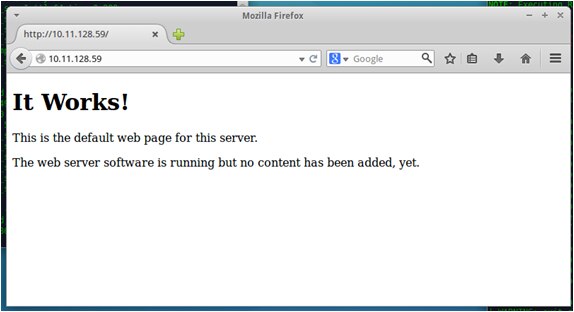

The webserver now runs and can be accessed by entering the boards I.P.  address in a web browser (i.p can be found by typing "ifconfig" into the terminal). But this is the default apache page, we need to change that.

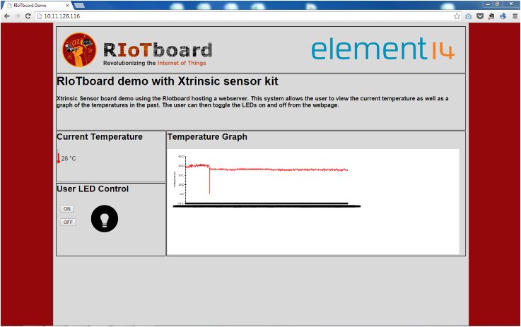

Now we need to get the basic web pages up and running, this includes 3 php pages to display "current temperature", "temperature graph", and "control the LED". This is just a matter of copying them into the "/var/www" folder.
Next we need to link them into one webpage.
To do this we are going to use an HTML page which has "iframes" showing the php pages in a table layout to make it a bit more attractive.
This HTML page will be called "index.html" so it is auto loaded by apache whenever someone accesses the server, and it will display all the php pages through "iframes".
Fine Tuning the Web Pages:
Now we are going to fine tune the web pages to give them a more professional look and to make them more user friendly.
To do this I have changed all of the php files ever so slightly, this gives them better control and integration into the HTML page.
I have removed all the text from the php files, got the led control file to load the appropriate bulb picture depending on whether the LED is on or off, got the current temp php file to display a °C sign, and got the graph to delete any data in the sql database that is older than 15 mins, this speeds load time and reduces excessive data.

Every web page needs some pictures and this is no different, we are going to add a RIoTboard logo and an element14 logo at the top of the page, and a background behind everything.
We are also going to add two LED pictures so the "led_blink.php" file can load the appropriate one; depending on if the led is ON or OFF.
