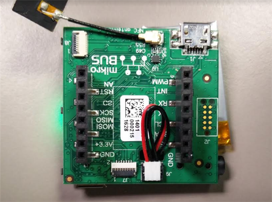

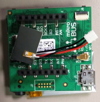

The battery connector is J9 as shown in the picture below. Move the NFC antenna to get clear access to the battery connector.

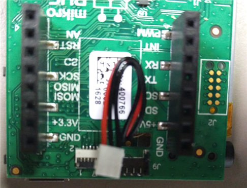

Fold the cable that comes connecting to battery as follows,

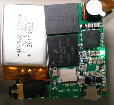

Snap the battery connector to J9 connector. Once connected the green LED would turn on the front side of WaRP7.
