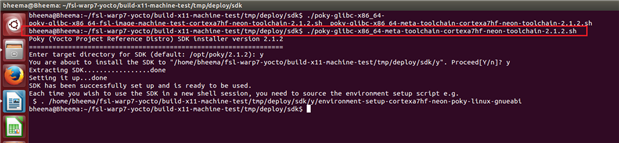

Next we need to install the tool chain, by giving below command:
root@Bheema:~/warp_appln# cd /home/bheema/fsl-warp7-yocto/build-x11-machine-test/tmp/deploy/sdk
root@Bheema:~/fsl-warp7-yocto/build-x11-machine-test/tmp/deploy/sdk# ./poky-glibc-x86_64-meta-toolchain-cortexa7hf-neon-toolchain-2.1.2.sh
the installation will ask default location /opt/poky/2.1.2
proceed further as shown below snap
now the toolchain has been installed in /opt/poky/2.1.2 folder

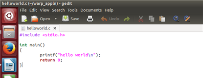

I have created my working folder as “warp_appln” under home directory create helloworld.c with below contents inside this directory:
root@Bheema:~/warp_appln# gedit helloworld.c
#include <stdio.h>
int main()
            printf("hello world\n");
            return 0;

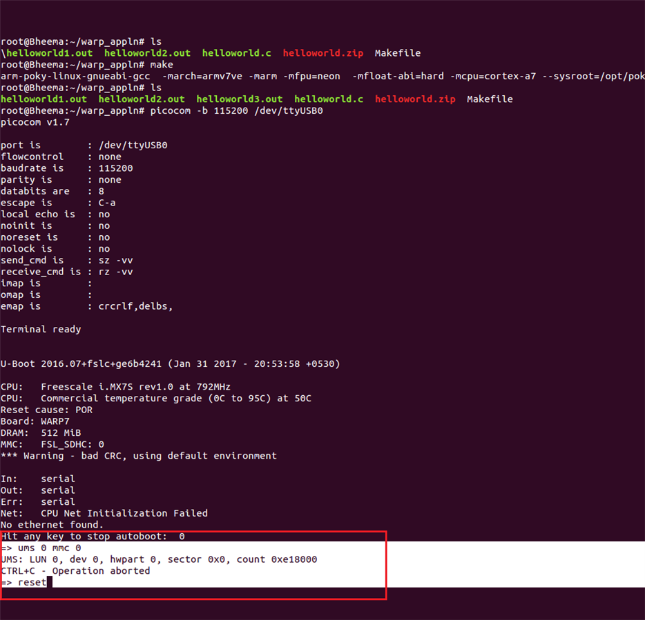

copying the helloworld.out to warp board using u-boot command
Note: we are proceeding further assuming your warp7 board is already loaded with pre-built image (which is working board)
now plug on the warp7 board to your computer and open a serial port terminal by using picocom command
root@Bheema:~/warp_appln# picocom -b 115200 /dev/ttyUSB0
now type below command at u-boot prompt

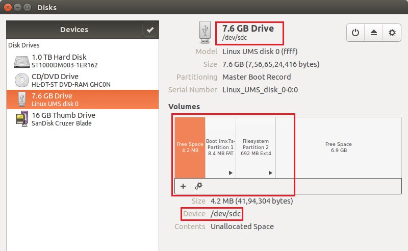

=>ums 0 mmc 0
you can see the warp7 emmc memory gets detected as shown below:
these are mounted on “/dev/sdc” with 3 partitions:
Boot: ~9 MB: “/media/bheema/Boot imx7s-” which is u-boot for warp7 and
rootfs: ~700MB: “/media/bheema/84804b4b-bc0e-4b3d-ac36-870eae0aca0f” where our linux kernel is loaded
/dev/sdc is available to user to copy the compiled executable files
root@Bheema:~/warp_appln# cp *.out /media/bheema/84804b4b-bc0e-4b3d-ac36-870eae0aca0f/
you can see that we have copied / transfered all the 3 executables  to warp7 board
you can verify the exact file has been copied to target board by checking crc checksum
root@Bheema:~/warp_appln# md5sum helloworld1.out
2e5191e3cd9134b78192fff8426d9ba8  helloworld1.out
root@Bheema:~/warp_appln# md5sum /media/bheema/84804b4b-bc0e-4b3d-ac36-870eae0aca0f/helloworld1.out
2e5191e3cd9134b78192fff8426d9ba8 /media/bheema/84804b4b-bc0e-4b3d-ac36-870eae0aca0f/helloworld1.out
now type ctrl+c on u-boot window and type reset
=> ctrl+c
=> reset
=> ums 0 mmc 0
UMS: LUN 0, dev 0, hwpart 0, sector 0x0, count 0xe18000
CTRL+C - Operation aborted
  => reset
warp board will be reset with changes wait till login screen occurs

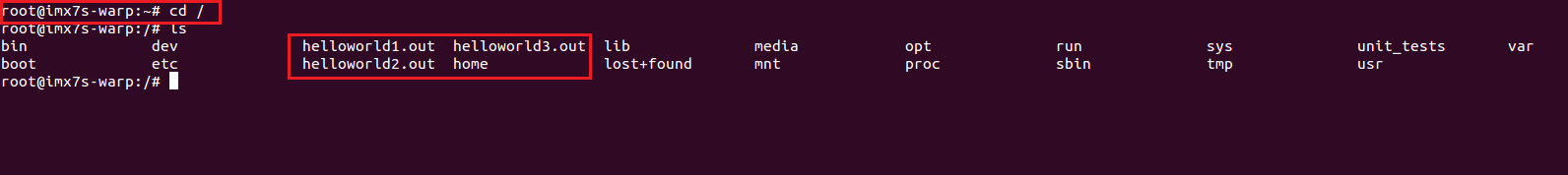

you can execute the helloworld.out as shown below:
root@imx7s-warp:/# ./helloworld1.out
hello world
root@imx7s-warp:/# ./helloworld2.out
hello world
root@imx7s-warp:/# ./helloworld3.out
hello world
root@imx7s-warp:/#
