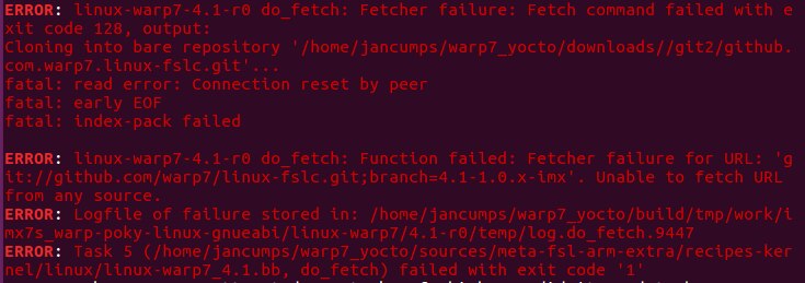

While kernel build is in process you might encounter an error wrt imx7s-warp.dtb.
This will happen is there is no imx7s-warp.dts file in below directory.
~/warp7_yocto/build/tmp/work/imx7s_warp-poky-linux-gnueabi/linux-warp7/4.1-r0/git/arch/arm/boot/dts
below is a snapshot from the log file that captured the above  error.
In that case copy the imx7s-warp.dts from the attachments to the below directory:
Now hit build again.

    Jan Cumps over 9 years ago in reply to Jan Cumps
    The build exited with errors (using a plain ubuntu install)
    ERROR: linux-warp7-4.1-r0 do_package: QA Issue: kernel-devicetree is listed in PACKAGES multiple times, this leads to packaging errors. [packages-list]
    ERROR: linux-warp7-4.1-r0 do_package: Fatal QA errors found, failing task.
    ERROR: linux-warp7-4.1-r0 do_package: Function failed: do_package
    <sadface/>
    Failed after half a day for (I think) network issues. Bgrtfhiouqsf*%µ$
    Restarting the build
