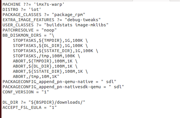

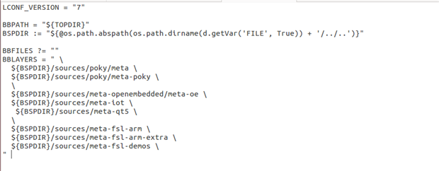

Now a build directory is created under ~/warp7_yocto directory.
It contains the build system settings for warp7 machine(i.e local.conf) and yocto bitbake layers path information (i.e bblayers.conf).
local.conf
bblayers.conf

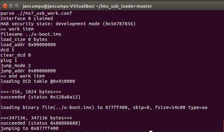

    Jan Cumps over 9 years ago in reply to bwelsby
    Cooking with gas:
    Brian Welsby wrote:
    Now where do you go from here?
    Brian
    Many plans. But the first thing I did was back up that Virtual Machine so that I have a point to revert to ...
