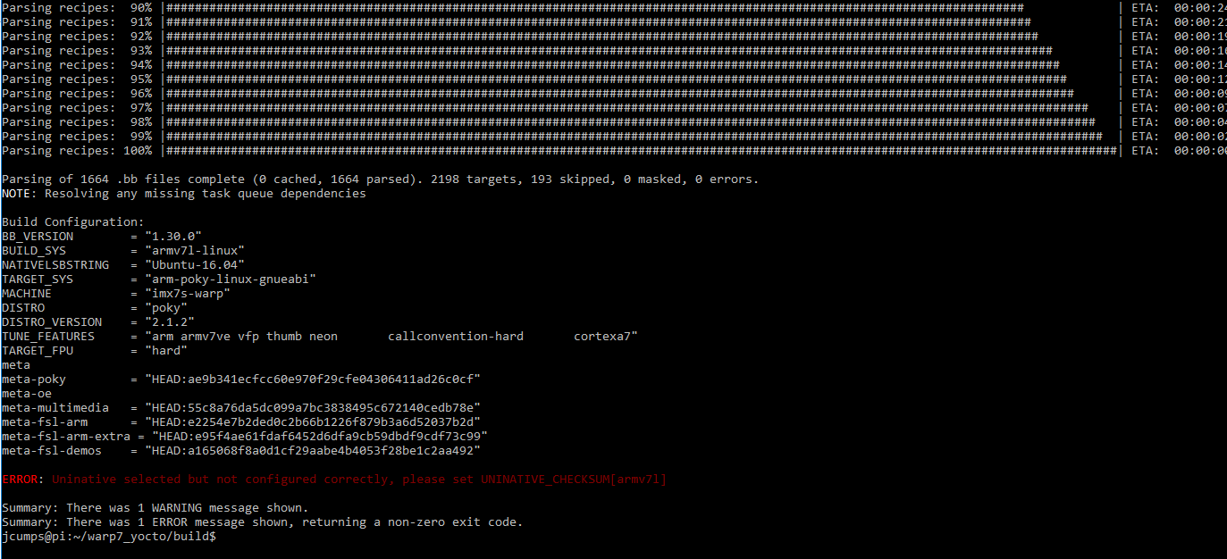

    To resolve ERROR: Uninative selected but not configured correctly, please set UNINATIVE_CHECKSUM[armv7l]:
    I'm following advice on this issue report: https://github.com/openbmc/openbmc/issues/500
    and added at the end of ~/warp7_yocto/build/conf/local.conf :
    INHERIT_remove = "uninative"
    There's another issue that suggests a different approach that I haven't tried:
    https://github.com/openbmc/openbmc/issues/640#issuecomment-270523012
    These issues are raised for non-warp7 builds
    This time the Pi died during the bitcake, Restarting it...
    Jan Cumps over 9 years ago in reply to Jan Cumps
    I undid the change in imx7s-warp.conf.
    It goes a significant step further now, then ends with bitcace throwing a different error Uninative selected but not configured correctly, please set UNINATIVE_CHECKSUM[armv7l]
    bitbake core-image-minimal -c fetchall
    Summary: There was 1 WARNING message shown.
    Summary: There was 1 ERROR message shown, returning a non-zero exit code.
    I'll google-fu for a solution...
