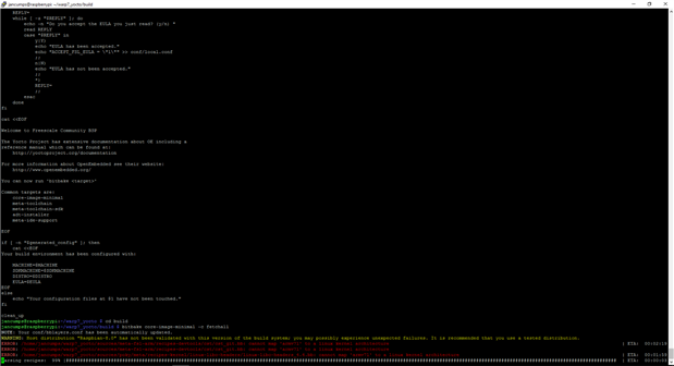

    jancumps@raspberrypi:~/warp7_yocto/build $ bitbake core-image-minimal -c fetchall
    NOTE: Your conf/bblayers.conf has been automatically updated.
    WARNING: Host distribution "Raspbian-8.0" has not been validated with this version of the build system; you may possibly experience unexpected failures. It is recommended that you use a tested distribution.
    ERROR: /home/jancumps/warp7_yocto/sources/meta-openembedded/meta-multimedia/recipes-multimedia/sox/sox_14.4.0.bb: Unable to determine endianness for architecture 'armv7l'                                                   | ETA:  --:--:--
    ERROR: /home/jancumps/warp7_yocto/sources/meta-openembedded/meta-multimedia/recipes-multimedia/sox/sox_14.4.0.bb: Please add your architecture to siteinfo.bbclass
    ERROR: Failed to parse recipe: /home/jancumps/warp7_yocto/sources/meta-openembedded/meta-multimedia/recipes-multimedia/sox/sox_14.4.0.bb
    Summary: There was 1 WARNING message shown.
    Summary: There were 3 ERROR messages shown, returning a non-zero exit code.
    Fixed that in /home/jancumps/warp7_yocto/sources/poky/meta/classes/siteinfo.bbclass
    Then
    ERROR: /home/jancumps/warp7_yocto/sources/meta-fsl-arm/recipes-devtools/cst/cst_git.bb: cannot map 'armv7l' to a linux kernel architecture                                                                                   | ETA:  00:02:19
    ERROR: /home/jancumps/warp7_yocto/sources/poky/meta/recipes-kernel/linux-libc-headers/linux-libc-headers_4.4.bb: cannot map 'armv7l' to a linux kernel architecture
    Then it fully hangs at 99% for more then 10 hours without a change or progress:
    Parsing recipes:  99% |####################################################################################################################################################################################################  | ETA:  00:00:03
    I hope that using Ubuntu instead of Rasberry's debian works...
