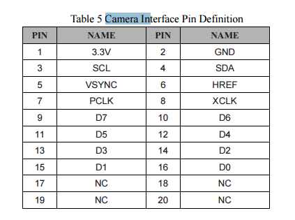

I have  STM32F4DIS-BBSTM32F4DIS-BB board and OV5640 camera http://www.arducam.com/camera-modules/5mp-ov5640/
via DVP interface

I need to connect them together.
Do I need to solder something to the BB board test point 22 and then connect it to the camera connector XCLK
or
can I just use whatever timer output pin and set it to generate 24 MHz or whatever frequency I need directly?
What is M+? What voltage it requires to power it up?
Please advise.

    About the XCLK I think that the  STM32F4DIS-CAMSTM32F4DIS-CAM connects the camera clock to the PA6 so you can do it in the same way no need to modify the base board
    About the VCM, as far as I know is a power supply for the auto-focus, you must check if it can work in 3V3, I think typically are lower voltages.

    PCLK goes from the camera and is input for mcu. XCLK goes to the camera and mcu output. I am pretty sure that mcu gpio should be able to handle it but want to know for certain.
    What is M+ (VCM) voltage? Don't want to guess either!

    You are right about the clock, so the best option will probably be the one you say, connect it to tp22.
    And about M+, I mean check the datasheet or any info from the supplier, it will depend on what is integrated inside your hardware, some hardware add integrated voltage regulators, for example the one you say has an integrated 1.5V voltage regulator for the core, and for the analog says typically 2.8V.

    I am looking now the schematics for the arducam shield, just to know which voltage injects to the arducam, but it seems to use a 16-pin connector, quite confusing.
    Do you know for which hardware or sheield is your arducam designed to?

    See this link:
    http://www.arducam.com/downloads/shields/ArduCAM_RevC+_Camera_Shield_DS.pdf
    This shield is supposed to work with the different arducams.
    See at page 6 this image:
    So I guess you can use your cam without connecting VCM, reset and power down.

    hmmm....
    I saw that, but p.5
    http://boundarydevices.com/wp-content/uploads/2014/12/CM8359-B500SA-E_V0.1.pdf
    points to 2.8V
    https://cdn.sparkfun.com/datasheets/Sensors/LightImaging/OV5640_datasheet.pdf
    look ch 3.3
    0 e14 Contributor over 10 years ago in reply to e14 Contributor
    Auto-Focus Specification
    NO.                Item                                    Specification
    1                    Auto-Focus Type                VCM (Voice Coil Motor)
    2                    VCM Driver                         Sensor internal driver
    3                   Power Supply                      2.6~3.3V
    4                   Rated Current                      ≤100mA
    5                   Resistance                          16±2Ω
    6                   Focusing Range                 10cm to infinity
