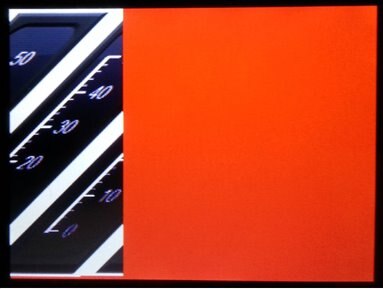

Hi everyone after a long time missing as I was designing a PCB I am back on programming. I need to load images on a 320*240 screen. So far I managed to load pictures 320*240 big and any other pictures with 320*x size where x can be any number between 1 to 240. But if I change the width of the picture (ie the 320) becomes sort of torsion (look on images below, the background is red in order to highlight where the picture starts and where it ends the size of this picture is 120*240). I have been trying to understand why this is happening but with no success :/. Below is the functions used to paint the picture, any help would be greatly appreciated thanks.

These images are photos taken of the LCD screen in operation.
Image 1: 100*240 resolution picture
Image 2: 320*144 resolution picture:

    Just a guess, but perhaps
    LCD_SetDisplayWindow(0, 0, 100, 240);
    should be
    LCD_SetDisplayWindow(0, 0, 99, 239);
    (i.e. maybe the range is inclusive of the upper limit value).

    0 philip-1992 over 12 years ago in reply to shabaz
    It seems that the width had to be 1 pixel less as you have told me!! Thank you for this, I have been stuck on this problem for 2 days!! What is troubling me is why do I need to subtract 1 pixel??

    It's just a guess, I could be very wrong. Maybe the function expects pixel position, and not width.
    It should be in the SSD2119 documentation, to see what  SSD2119_H_RAM_START_REG and
    SSD2119_H_RAM_END_REG means.
    Maybe the person who wrote LCD_SetDisplayWindow misunderstood, and specified a width as a parameter when it was really the end pixel position : ( not sure. I don't have this board or display unfortunately, so I could be talking nonsense : (

    0 e14 Contributor over 12 years ago in reply to philip-1992
    FWI, 0 is the first location, 239 is the last. Your math teacher wont agree but the computer understands. ;-)
