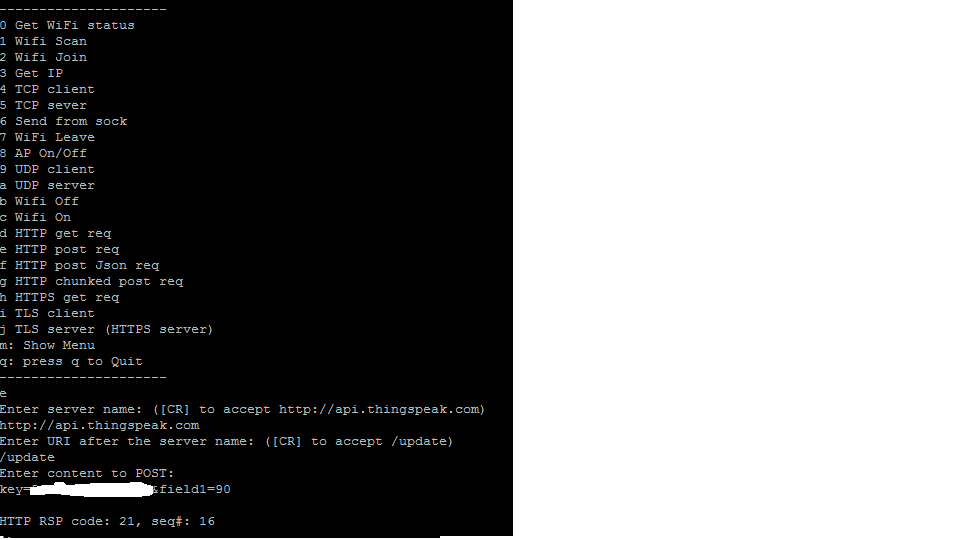

I am trying to send an HTTP Post to a channel I created on Thingspeak.com.  I am using the provided code for the Keil environment and have tried multiple different things to try to post a value to my channel.  Below is the configuration of the sendHttpPostDemo() function.  The only modification I made was to change the content type from "text/html" to "application/x-www-form-urlencoded".  When I run the application I type following
e (selects HTTP Post)
http://api.thingspeak.com (server)
/update (uri)
mykey&field1=90
I get the following message:
HTTP RSP code: 21, seq #13
When I look up the code this is decimal 21 which is 0x15.  According to the SNIC Serial Interface manual this represents "SNIC_INVALID_ARGUMENT".  There is no more detail regarding the invalid argument.
I am able to post values to Thingspeak using Mozilla HTTP Poster program.  This appears to be something directly related to how the code is managing the request for the post.  Any help would be appreciated.

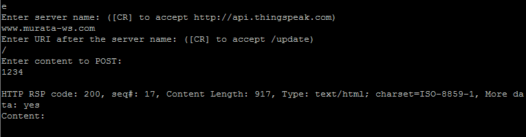

    Just as a follow up.  I am able to send an HTTP post to "www.murata-ws.com/" site.  See pic below, there is additional info that was printed out below the "Content:" portion as well.  So I am able to post, but for some reason I cannot post to my Thingspeak channel.

    So I found my issue that I have been banging my head over all afternoon.  The solution is quite simple.  When I am posting to the server I need to exclude the "HTTP://" portion.  So when it asks for the server location you just need to type "api.thingspeak.com".
