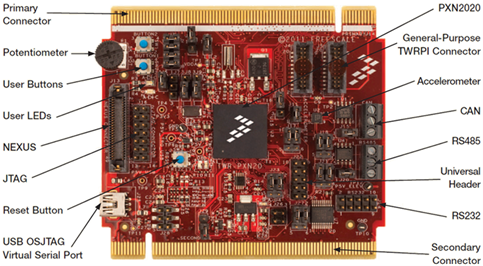

The Freescale's TWR-PXN20-KITTWR-PXN20-KIT is part of the Freescale Tower System portfolio, a modular development platform that enables rapid prototyping and tool re-use through reconfigurable hardware. Elevate your design to the next level with this industrial powerhouse by building your Tower System today. The TWR-PXN20-KITTWR-PXN20-KIT Tower System module kit consist of TWR-PXN20TWR-PXN20 board module with tower system Serial Module TWR-SERTWR-SER  and Tower System Elevator Module TWR-ELEV.TWR-ELEV.

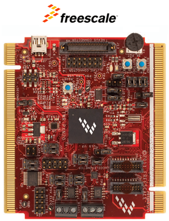

The Freescale's TWR-PXN20TWR-PXN20 is a modular development platform that enables rapid prototyping and tool re-use through reconfigurable hardware. Elevate your design to the next level with this industrial power house by building your Tower System today. The 32-bit dual core PXN20 Power ArchitectureRegistered microcontrollers support a variety of communication protocols, allowing the designer to put together a cost effective, reliable industrial gateway with cutting-edge performance. A large amount of on-chip flash, on-chip SRAM with error correction code capability, 36-channel ADC, dual cores and a host of serial I/Os make the PXN20 a compelling solution for your next design cycle.

  • MPXN2020VMG116 MCU: Up to 116 MHz 32-bit dual-core MCU: e200z6 and e200z0, 2 MB on-chip flash, 592 KB on-chip SRAM, 32-channel DMA, 6x UART, 3x SPI, 6x CAN, 4x I2C, 36-channel 10-bit ADC, Fast Ethernet controller (FEC), debug JTAG interface and Nexus 3, timed I/Os: eMIOS 24-channel, 16-bit, internal timers: programmable interrupt timers 8-channel, 32-bit, -40°C/+105°C temp. range, package options 208 MAPBGA, low-power modes)
  • CAN transceiver
  • RS485 half duplex transceiver
  • RS232 transceiver
  • Four LEDs for user interface
  • Two mechanical push buttons for user interface
  • Potentiometer for ADC testing
  • 3-axis accelerometer (MMA8451QMMA8451Q)
  • General-purpose TWRPI socket (Tower plug-in module)
  • OSJTAG open source JTAG debug interface (MC9S08JM60MC9S08JM60)
  • OSJTAG virtual serial port using USB
  • NEXUS, JTAG debug interface
  • Universal header (GPIO)
