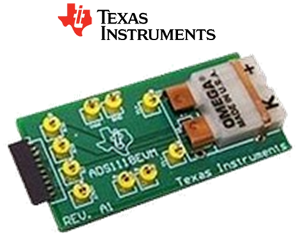

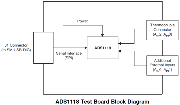

The Texas Instruments ADS1118EVMADS1118EVM is a complete solution for evaluation of the ADS1118ADS1118 Ultra-Small, Low Power,Precision 16 Bit Analog to Digital Converter. Power and I/O are provided via USB connection and a simple software interface. Inputs for a thermocouple are provided on board, plus two additional uncommitted inputs are available. This evaluation module (EVM) allows evaluation of all aspects of the ADS1118IDGSTADS1118IDGST, a 16-bit, delta-sigma analog-to-digital converter (ADC)
ADS1118ADS1118 16-Bit ADC with Integrated MUX, PGA, Temperature Sensor, Oscillator, and Reference:
  • The ADS1118IDGSTADS1118IDGST is a precision ADC.
  • It features onboard reference and oscillator, as well as 16 bits of resolution.
  • The ADS1118IDGSTADS1118IDGST can perform up to 860 samples per second (SPS) and has an onboard programmable gain amplifier (PGA) that allows input ranges from ±256 mV to ±6.144 V.
  • It also contains an input multiplexer that allows each input to be used with reference to ground, or two differential inputs.
  • The ADS1118IDGSTADS1118IDGST can perform conversions at rates up to 860 samples per second (SPS).
  • An onboard programmable gain amplifier (PGA) is available on the ADS1118IDGSTADS1118IDGST that offers input ranges from the supply to as low as ±256mV. This range allows both large and small signals to be measured with high resolution.
  • The ADS1118IDGSTADS1118IDGST also features an input multiplexer (MUX) that provides two differential or four single-ended inputs.
  • The ADS1118IDGSTADS1118IDGST can also function as a high-accuracy temperature sensor. This temperature sensor can be used for system-level temperature monitoring or cold junction compensation for thermocouples.
  • The ADS1118IDGSTADS1118IDGST operates either in continuous conversion mode or a single-shot mode that automatically powers down after a conversion. Single-shot mode significantly reduces current consumption during idle periods. The ADS1118 is specified from –40°C to +125°C.
Key Applications: Temperature Measurement(Thermocouple Measurement, Cold Junction Compensation, Thermistor Measurement), Portable Instrumentation, Factory Automation and Process Controls

Kit Features
Key Features for ADS1118EVMADS1118EVM Evaluation Module:
  • USB Power and I/O
  • Small Form Factor
  • Simple Software Interface
  • Kit includes K type thermocouple
Features for ADS1118ADS1118 ADC:
  • Ultra-Small QFN Package: 2mm × 1,5mm × 0,4mm
  • Wide Supply Range: 2.0V to 5.5V
  • Low Current Consumption:
    • Continuous Mode: Only 150µA
    • Single-Shot Mode: Auto Shutdown
  • Programmable Data Rate:     8SPS to 860SPS
  • Single-Cycle Settling
  • Internal Low-Drift Voltage Reference
  • Internal Temperature Sensor:
    • 0.5°C Max Error
  • Internal Oscillator
  • Internal PGA
  • Four Single-Ended or Two Differential Inputs

The Texas Instruments ADS1118EVMADS1118EVM ADS1118IDGSTADS1118IDGST Evaluation Module is supplied with below contents:
  • PCB Evaluation Board
  • SM-USB-DIG Platform PCB
  • USB Extender Cable
  • SM-Dig Connector Ribbon Cable
  • K-Type Thermocouple
  • User’s Guide CD-ROM
