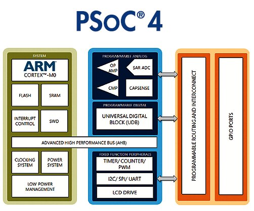

PSoCRegistered 4 is Cypress's newest ARM-based PSoC, featuring the low-power Cortex-M0 core combined with PSoC's unique programmable mixed-signal hardware IP, resulting in the industry's most flexible and scalable low-power mixed-signal architecture. Use PSoC 4 with PSoC CreatorTm to create unique designs, shorten development schedules, and accelerate your time-to-market.
The PSoC 4 architecture enhances Cypress’s patented, industry-leading CapSense capacitive-touch sensing technology by offering significant leadership in noise immunity. In addition to capacitive sensing, PSoC 4 targets field-oriented control (FOC) motor control, temperature sensing, security access, portable medical, and many other applications.
The PSoC 4 architecture offers best-in-class power leakage of 150 nA while retaining SRAM memory, programmable logic, and the ability to wake up from an interrupt. In stop mode, it consumes only 20 nA while maintaining wake-up capability. It has the widest operating voltage range of any Cortex-M0-based device, enabling full analog and digital operation from 1.71V to 5.5V. The architecture facilitates integrated, high-performance custom signal chains and provides both configurable analog and flexible routing.
PSoC 4 leverages the PSoC Creator integrated design environment. The IDE’s easy-to-use graphical interface enables designers to drag and drop pre-characterized, production-ready analog and digital IP blocks—PSoC Components—into a single PSoC device to create customized, feature-rich, and highly differentiated end products. Cypress’s platform solution—PSoC 4, PSoC Creator and PSoC Components—simplifies and accelerates the design process, reduces bills of material, and provides extraordinary system value.

  • 32-bit Cortex-M0 CPU with single-cycle multiply delivering up to 43 DMIPS at 48 MHz
  • Up to 32-KB flash and 4-KB SRAM
  • Four independent center-aligned pulse-width modulators (PWMs) with complementary dead-band programmable  outputs and synchronized analog-to-digital converter (ADC) operation
  • Up to 1 Msps 12-bit ADC including sample-and-hold (S/H) capability with zero-overhead sequencing
  • Up to two opamps with comparator mode and successive approximation register (SAR) input buffering capability
  • Two low-power comparators
  • Two serial communication blocks (SCB) to work as SPI/UART/I2C serial communication channels
  • Up to four programmable logic blocks, known as universal digital blocks (UDBs)
  • CapSenseRegistered and segment LCD drive
  • Low-power operating modes: Sleep, Deep-Sleep, Hibernate, and Stop
  • Programming and debug system through serial wire debug (SWD)
  • Fully supported PSoC CreatorTm IDE tool
