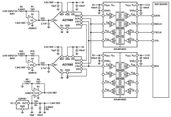

This circuit provides galvanic isolation for high speed, high accuracy, simultaneous sampling analog-todigital conversion applications. The 16-bit AD7685AD7685 PulSAR ADC is versatile and allows monitoring of multiple channels through daisy chaining. An input circuit based on the AD8615AD8615 op amp level shifts, attenuates, and buffers a ±10 V industrial signal to match the input requirements of the ADC. The flexible circuit includes a precision ADR391ADR391 reference and two quadchannel ADuM1402 digital isolators to provide a compact and cost effective solution to a popular industrial data acquisition application.
The AD7685AD7685 is a 16-bit, charge redistribution successive approximation (SAR) analog-to-digital converter (ADC) that operates from a single VDD power supply from 2.3 V to 5.5 V. It contains a low power, high speed, 16-bit sampling ADC with no missing codes, no pipeline delay, an internal conversion clock, and a versatile serial interface port. The ADC also contains a low noise, wide bandwidth, short aperture delay, track-and-hold circuit.
The complete analog signal chain runs on a single 5 V supply. The ADR391BUJZ-R2ADR391BUJZ-R2 low dropout 2.5 V reference and the U13 rail-torail CMOS AD8615 op amp develop the 4.5 V reference voltage for the ADCs.

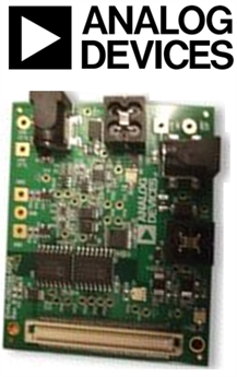

This circuit uses the EVAL-CN0194-SDPZEVAL-CN0194-SDPZ circuit board and the EVAL-SDP-CB1ZEVAL-SDP-CB1Z System Demonstration Platform (SDP-B) evaluation board. The two boards have 120-pin mating connectors, allowing for the quick setup and evaluation of the circuit’s performance. The EVAL-CN0194-SDPZ board contains the circuit to be evaluated and the SDP evaluation board is used with the CN0194 evaluation software to capture the data from the EVAL-CN0194-SDPZ circuit board.

  • An input circuit based on the AD8615AD8615 op-amp level shifts, attenuates, and buffers a ±10 V industrial signal to match the input requirements of the ADC
  • The flexible circuit includes a precision ADR391ADR391 reference and two quadchannel ADuM1402 digital isolators to provide a compact and cost effective solution to a popular industrial data acquisition application

Kit Contents
The Analog Devices EVAL-CN0194-SDPZEVAL-CN0194-SDPZ kit is supplied with below contents:
  • Evaluation Board
