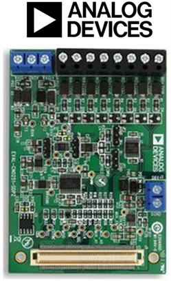

Analog Devices: CN0251 Reference Design for A Flexible 4-Channel Analog Front End for Wide Dynamic Range Signal Conditioning
Kit Overview
The EVAL-CN0251-SDPZEVAL-CN0251-SDPZ circuit is a flexible signal conditioning circuit for processing signals of wide dynamic range, varying from several mV p-p to 20 V p-p. The circuit provides the necessary conditioning and level shifting and achieves the dynamic range using the internal programmable gain amplifier (PGA) of the high resolution analog-to-digital converter (ADC).
The EVAL-CN0251-SDPZEVAL-CN0251-SDPZ circuit provides programmable gain, high CMR, and high input impedance. The input signal passes through the 4-channel ADG1409 multiplexer into the AD8226AD8226 low cost, wide input range instrumentation amplifier. The AD8226 offers high CMR up to 80 dB and very high input impedance (800 MΩ differential mode and 400 MΩ common mode). A wide input range and rail-to-rail output allow the AD8226 to make full use of the supply rails.
The AD8475 is a fully differential, attenuating amplifier with integrated precision gain resistors. It provides precision attenuation (G = 0.4 or G = 0.8), common-mode level shifting, and single-ended-to-differential conversion. The AD8475 is an easy to use, fully integrated precision gain block, designed to process signal levels up to ±10 V on a single supply. Therefore, the AD8475 is suitable for attenuating signals from the AD8226 up to 20 V p-p, while maintaining high CMR and offering a differential output to drive the differential input ADC.
The AD7192 is a 24-bit sigma-delta (Σ-Δ) ADC with an internal PGA. The on-chip, low noise gain stage (G = 1, 8, 16, 32, 64, or 128) means that signals of large and small amplitude can be interfaced directly to the ADC.
The circuit test setup uses the EVAL-CN0251-SDPZEVAL-CN0251-SDPZ circuit evaluation board and the System Demonstration Platform (SDP-B) evaluation board (EVAL-SDP-CB1ZEVAL-SDP-CB1Z) should be purchased seperately. The two boards have 120-pin mating connectors, allowing for the quick setup and evaluation of the performance of the circuit. The EVAL-CN0251-SDPZ board contains the circuit to be evaluated and the SDP is used with the CN-0251 evaluation software to capture the data from the EVAL-CN0251-SDPZ. The SDP is also used to control the input multiplexer and various functions within the AD7792BRUZ.AD7792BRUZ. ADC.

Kit Contents
The Analog Devices EVAL-CN0251-SDPZEVAL-CN0251-SDPZ kit is supplied with below contents:
  • Evaluation Board
