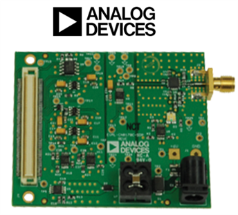

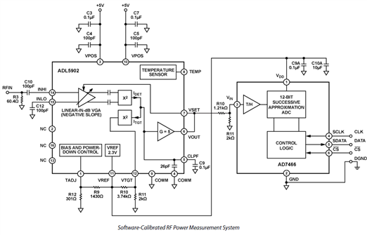

The EVAL-CN0178-SDPZEVAL-CN0178-SDPZ Evaluation board is a Software-Calibrated, 50 MHz to 9 GHz, RF Power Measurement System. It uses the ADL5902ADL5902 TruPwrTm detector to measure the rms signal strength of RF signals with varying crest factors (peak-to-average ratio) over a dynamic range of approximately 65 dB and operates at frequencies from 50 MHz up to 9 GHz.
The measurement result is provided as serial data at the output of a 12-bit ADC (AD7466AD7466). A simple 4-point system calibration at ambient temperature is performed in the digital domain. The interface between the RF detector and the ADC is straightforward, consisting of two signal scaling resistors and no active components. In addition, the ADL5902ADL5902 internal 2.3 V reference voltage provides the supply and reference voltage for the micropower ADC. The AD7466BRTZ-R2AD7466BRTZ-R2 has no pipeline delay and is operated as a read-only SAR ADC. The overall circuit achieves temperature stability of approximately ±0.5 dB.
The circuit evaluation uses the EVAL-CN0178-SDPZEVAL-CN0178-SDPZ circuit board and the EVAL-SDP-CB1ZEVAL-SDP-CB1Z System Demonstration Platform (SDP-B) evaluation board. The two boards have 120-pin mating connectors, allowing for the quick setup and evaluation of the circuit’s performance. The EVAL-CN0178-SDPZ board contains the circuit to be evaluated, as described in this note, and the SDP evaluation board is used with the CN0178 evaluation software to capture the data from the EVAL-CN0178-SDPZ circuit board.

  • The RF signal being measured is applied to the input of the ADL5902
  • The power supply voltage and reference voltage for the AD7466BRTZ-R2AD7466BRTZ-R2 12-bit ADC are provided by the ADL5902 internal 2.3 V reference.
  • The overall circuit achieves temperature stability of approximately ±0.5 dB.
