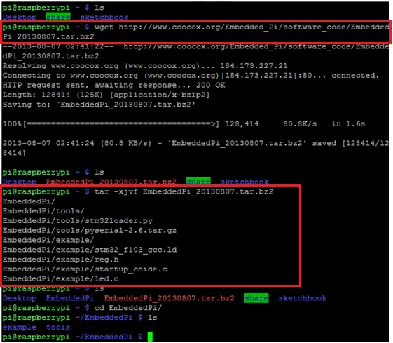

Step 1:  Download the resource kit from CooCox website and extract all the files:- To start first we need to download few resource files provided by CooCox team, which includes STM32 MCU startup code, STM32 ISP tool (written in Python), Serial library for Python (used by ISP tool) and LED blinky example. Use the below commands to download and extract all the files:
$wget http://www.coocox.org/Embedded_Pi/software_code/EmbeddedPi_20130807.tar.bz2
$tar –xjvf EmbeddedPi_30130807.tar.bz2
File Extracted Location: /home/pi/EmbeddedPi

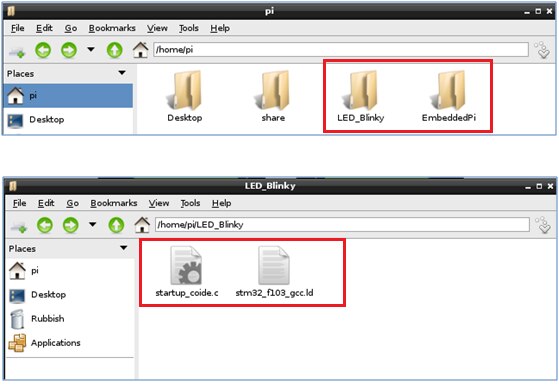

Step 3: Create a directory named “LED_Blinky” and copy “startup_coide.c” and “stm32_f103_gcc.ld” files to this directory from “/home/pi/EmbeddedPi/example” directory:
pi@raspberrypi ~ / EmbeddedPi $cd ..
pi@raspberrypi ~ $mkdir LED_Blinky
pi@raspberrypi ~ $cd LED_Blinky
pi@raspberrypi ~ /LED_Blinky $cp .. /EmbeddedPi/example/startup_coide.c .
pi@raspberrypi ~ / LED_Blinky $cp .. /EmbeddedPi/example/stm32_f103_gcc.ld .
As shown below:

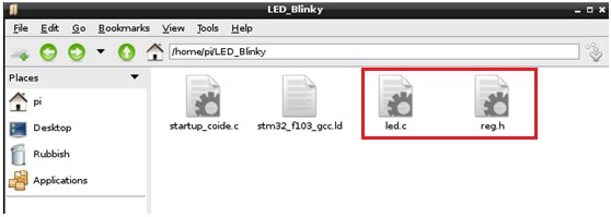

Step 4: Now create "led.c" & "reg.h" files and copy the below code to the respective files. You can use any editor of your choice:

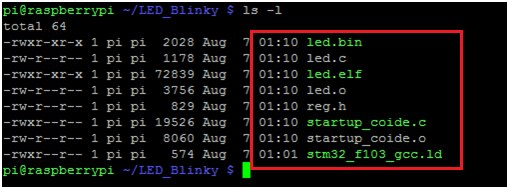

Step 5: Now we will use GCC compile to compile all these files and generate a binary .bin file. It’s a 3 step process; compile, link and create .bin file:
     1. Compile and convert the .c files into .o target files.
$ gcc -mcpu=cortex-m3-mthumb -Wall -g -O0 -nostartfiles -c startup_coide.c -o startup_coide.o
$ gcc -mcpu=cortex-m3-mthumb -Wall -g -O0 -nostartfiles -I. -c led.c -o led.o
     2. Link the object files and create .elf file.
$ ld -Tstm32_f103_gcc.ld -o led.elf led.o startup_coide.o
     3. Generate .bin file from .elf file.
$ objcopy -Obinary led.elf led.bin
Now we have successfully compiled all the source files and generated a binary “led.bin” file. This is the file we need to download into Embedded Pi flash memory using ISP tool. You can use the “ls” command to see all the generated files as below:

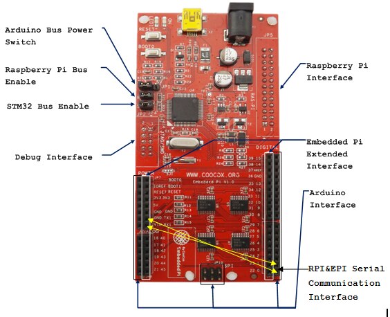

Step 6: Prepare your hardware; connect Raspberry Pi & Embedded Pi as below (please refer to Embedded Pi User Manual for detail):
  1. Setup the Embedded Pi in ST-Adapter mode - connect JP2, JP3 connection.
  2. Connect the Embedded Pi and Raspberry Pi using 26 pin ribbon cable.
  3. Connect Raspberry Pi and Embedded Pi UART communication port as shown in "Yellow Lines" below:
