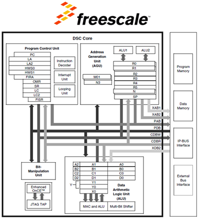

The DSP56800E core architecture represents the next step in the evolution of Freescale’s 16-bit DSP56800 Family of digital signal controllers. It provides low-cost, low-power, mid-performance computing, combining DSC power and parallelism with MCU-like programming simplicity. The DSP56800E core is a general-purpose central processing unit, designed for both efficient digital signal processing and a variety of controller operations.
A powerful multiply-accumulate (MAC) unit, with optional rounding and negation, enables the efficient coding of DSC and digital filtering algorithms. The DSP56800E’s large register set, powerful addressing modes, and bit-manipulation unit allow traditional control tasks to be performed with ease, without the complexity and limitations normally associated with DSCs. Assisting in the coding of general-purpose programs is support for a software stack; flexible addressing modes; and byte, word, and long-word data types.

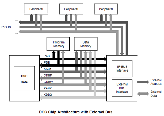

The multiply-accumulate (MAC) operation is the fundamental operation used in DSC. The DSP56800E family of processors has a dual Harvard architecture that is optimized for MAC operations. Figure 1-5 shows how the DSP56800E architecture matches the shape of the MAC operation. The two operands, C() and X(), are directed to a multiply operation, and the result is summed. This process is built into the chip in that two separate data memory accesses are allowed to feed a single-cycle MAC. The entire process must occur under program control to direct the correct operands to the multiplier and to save the accumulated result, as needed. Since the memory and the MAC are independent, the DSC can perform two memory moves, a multiply and an accumulate, and two address updates in a single operation. As a result, many DSC benchmarks execute very efficiently for a single-multiplier architecture.

The DSP56800E core architecture extends Freescale’s DSP56800 Family architecture. It is source-code compatible with DSP56800 devices and adds the following new features:
  • Byte and long data types, supplementing the DSP56800’s word data type
  • 24-bit data memory address space
  • 21-bit program memory address space
  • Three additional 24-bit pointer registers (one of which can be used as an offset register)
  • A secondary 16-bit offset register to further enhance the dual parallel data ALU instructions
  • Two additional 36-bit accumulator registers
  • Full-precision integer multiplication
  • 32-bit logical and shifting operations
  • Second read in dual read instruction can access off-chip memory
  • Loop count (LC) register extended to 16 bits
  • Full support for nested DO looping through additional loop address and count registers
  • Loop address and hardware stack extended to 24 bits
  • Three additional interrupt levels with a software interrupt for each level
  • Enhanced On-Chip Emulation (Enhanced OnCE) with three debugging modes:
    • Non-intrusive real-time debugging
    • Minimally intrusive real-time debugging
    • Breakpoint and step mode (core is halted)
