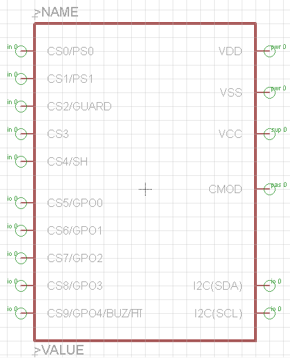

Symbol
The symbol is what you see on your schematic. If you name your symbol after the manufacturer's code then you will find that the design link for selecting parts works well.
My tips here are:
Don't make your symbol too small, you'll find that you can quickly run out of space for pin labels
Equally, spacing out the pins will make it easier to place the components around it.
Also don't feel the need to mirror the pin layout of your the device. I've grouped the power, sensors and I2C to make the schematics clearer.
Ensure your outline is centred on the control [+] provided. This will ensure people can easily move or set properties.
If a pin name is inverted you can indicate this by adding an ! in front of the name and that will give you a line over it.
When you add a pin you can specify the direction e.g. input, output or power. These are abreviated in the Eagle UI but the descriptions are provided in the help file and on Stephen Farnsworth Ilektronix blog. The pin direction is used in the Electrical Rule Check to make sure you've not wired two outputs together or shorted V+ to Gnd.
If you are creating a logic device then it's worth reading up on the SwapLevel as this would allow you to make parts where pins are interchangable e.g. the 2 inputs on a NAND gate are electrically equivalent so the end user could swap them to simplify routing of their PCB.
