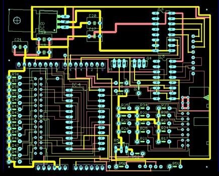

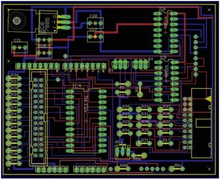

When  I did the wire (0 0)(100 0)(100 80)(0 80)(0 0); to find how much room that I had,
I then moved this so it was smaller and deleted the board outline that was smaller.
Looking at my PCB in Eagle, the brd file looks like this:
and looking at the gerbers in a viewer, they look like this:
What am I missing?
How do I create a board outline on my PCB so that is shows
up in my Gerber files?
thanks

    The board outline is defined by wires (lines) on layer 20.  It must be a
    closed shape.
    Cheers,
    James.
