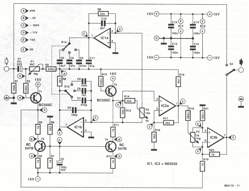

    Jerome wrote on Wed, 10 February 2010 13:44
    I prefer a lot the look of such schematics :
    http://www.experimentalistsanonymous.com/diy/Schematics/Tone%20Control%20an
    d%20EQs/Elektor%20Parametric%20EQ.gif
    As do I. BTW, those schematics are made with Altium Designer (not sure what
    version). In AD (all the way back to Protel99) the size and offset of both
    the pin label and pin number is controlled globally, the visibility and
    color of these are controlled per pin.
    IIRC a similar set of possibilities was used by PADS, but both of them also
    have a ridiculous large default offset for pin labels and items IMO.
    Then again, these programs are in a different league...
    A nice feature for Eagle would be the ability to scale (tiny, small,
    normal, large?) the dot and clock symbols: they are currently a tad too
    large for my taste. Together with controllable offset and orientation for
    both pin names and numbers, very compact yet readable symbols can be made.

    I was indeed referring to the implicitly generated texts for the name and
    number of each pins of a component, not the >VALUE and >NAME of the
    component itself.
    I was wondering if I could set somewhere the size of these text, by default
    quite large. It seems that the answer is negative. Same for the position of
    these text. I prefer a lot the look of such schematics :
    http://www.experimentalistsanonymous.com/diy/Schematics/Tone%20Control%20and%20EQs/Elektor%20Parametric%20EQ.gif
    where the pin number is present in the drawing (you can read it if you want
    to check something) but does not take the whole space around a component.
    This was just for aesthetics, not very important,
    Thanks,
    Jerome
