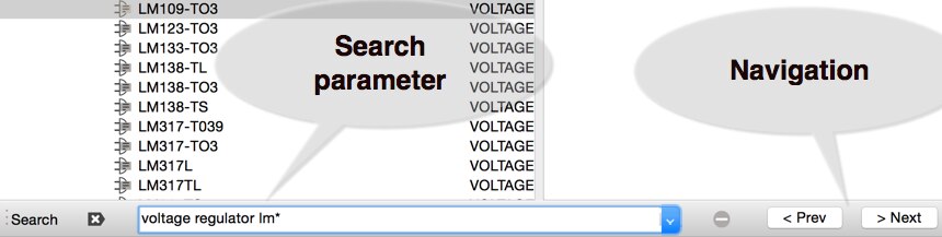

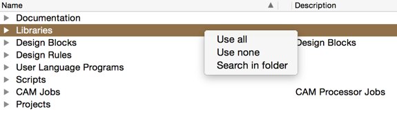

    For those that come across this thread.
    To search for a specific component
    Open up the eagle control panel right click on the library folder as shown in figure 1, an option to search will be available select it and a search box will appear at the bottom as shown in figure 2. Type in your parameters such as " voltage regulator lm* ", use of wildcards is allowed and it will display the results and allow navigation. This is handy to see if the component exists in your library and to make sure you don't duplicate your efforts by creating a new one.
    Figure 1 right click on folder
    Figure 2 searching for a component " voltage regulator lm* "
